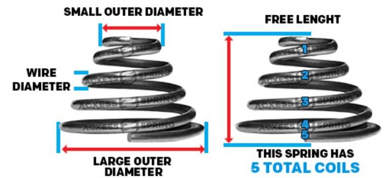

Hand waving explanation here, so interpret accordingly. A conical spring is a coil spring with one end wound to a smaller radius than the other end as in the image below.
The spring rate of a coil spring is proportional to the cube of the mean diameter. The mean diameter is equal to the outer diameter minus the wire diameter. The mean diameter of a conical spring is variable - each turn has a different mean diameter. The spring in the image above has a large end mean diameter about 2.5 times larger than the small end mean diameter. Since the spring rate is proportional to the cube of the mean diameter, the spring rate of the small end is about 15 times higher than the spring rate of the large end.
