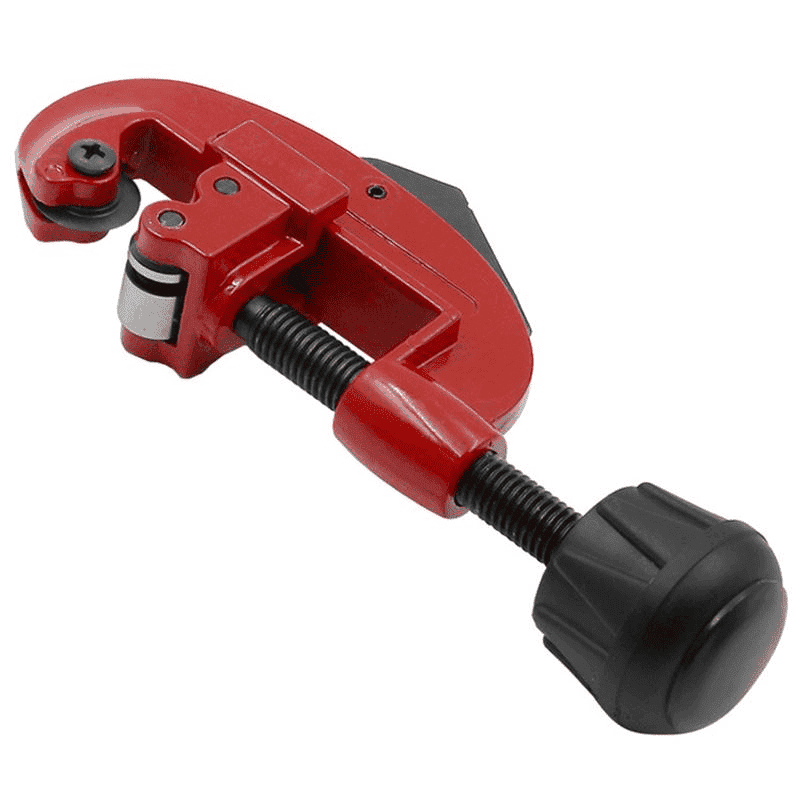

Sorry if I'm missing the obvious, but why not use a standard plumbing tube cutter?
[Legal disclaimer: I have not read Dave's other thread, so I may be negligent in my duties here. Also, I do not stay up late at night like some other users here <cough>, so I may have missed some other conversations about this. Nolo contendere...]
https://www.dhresource.com/0x0/f2/a...-tube-cutter-cutting-tool-18cm-adjustable.jpg
Yeah, now I remember why.
I'm cutting tubing lengths on the order of 2 mm. Like the pic. Tube cutters can't do that.

The reason for using the cutting wheel from a tube cutter against an internal mandrel is that the thin tube needs some support to stop it flexing. There is no need for the lathe if the mandrel is a close fit, and the pipe cutter can be kept square with the tube, so it does not cut a helical line.
I cut it in a lathe because I can repeat the cut against a fixed gauge and cut it square, even when the tube is flexible brass of softer plastic.
Right. So it will work whereas a standard tube cutter won't because a standard tube cutter needs a brace in either side the wheel. A lathe does not.

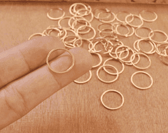

Tom.G said:
https://www.physicsforums.com/attachments/1615766799541-png.279788/
@DaveC426913 Would you be so kind as to post a photo of the finished item those rings belong to?
Thanks,
Tom
It's only been in the works for about 20 years, but sure.
Sorry - to clarify: that pic is pulled from the internet. It is not mine. And those hands aren't mine either.
Although I can post a photo of a single piece of a prototype.

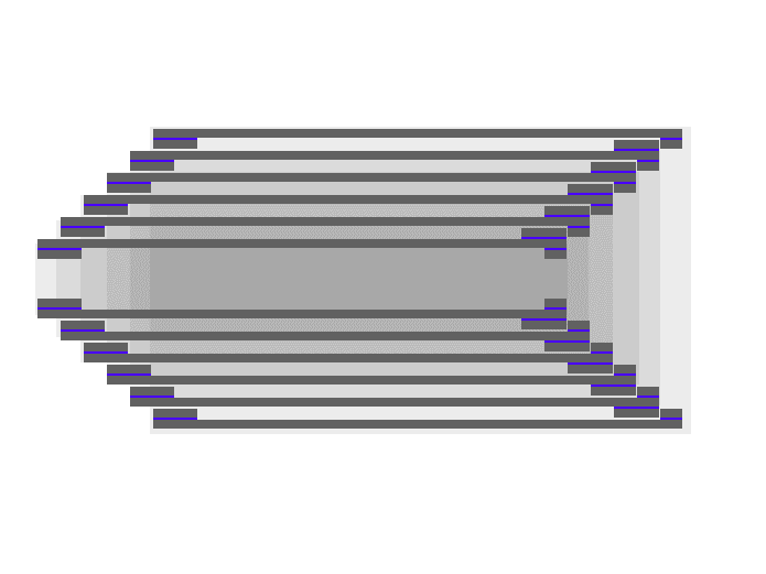

The cylinders are about 1" long each, and the rings are stoppers.
Here's six nested cylinders (long, grey), each with 3 stopper rings (short grey) soldered or glued to them (blue.)
This unit will telescope from about 1.25" to about 6".
I need 24 of them. Each of which requires 18 rings.

The key metric is that it must allow the object's sides to expand by at least a factor of 2 root(2) - i.e. ~1:2.828.
Not too hard, except that this cylinder only a part of the object's sides. The joint/corner elements take up room but do not likewise telescope - which means the cylinders must do a fair bit better than 1:2.828. Which is why I need to add nesting cylinders to the design until I achieve a sufficient telescoping ratio.
Likes MRFMengineer, Tom.G, Baluncore and 1 other person
