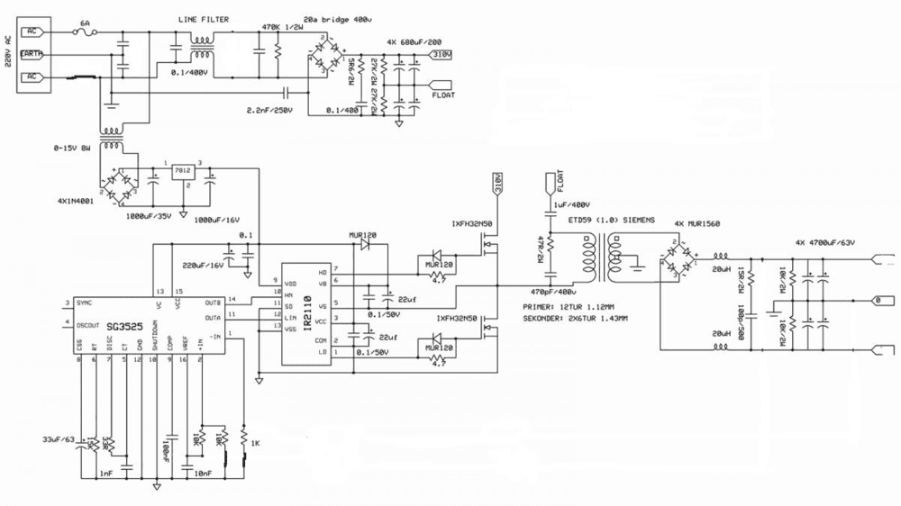

artis said:
"sharp" spikes seemingly at or near the switching frequency of the smps (around 50 Khz)
50kHz is a bit low. Could you please tell us the type of the control IC of the SMPS circuit?
Or, if it is a complete unit, then the type of the unit? If it is something DIY style, then a schematics or some photos?
It's a diy thing. the secondary smoothing capacitances are larger than in the schematic as I was kind with capacitors.
I saw the schematic online, originally it had optocoupler for output regulation but it didn't work too well and made the frequency unstable so I disabled that, for a moderate load works fine.
yes its an audio amp, not exactly a small power headphone one rather a 2x500 watt class AB topology, so on large speakers can't hear the parasitic oscillations but still the ugly image from my scope sits in my head.
This is more of a learning thing for me than trying to get audio perfection as I have other amps.
I was just wondering could I maybe make those chokes somehow function better than they do, maybe I need to add a short circuited secondary on the chokes with a small capacitor in series so for lower frequencies it would seem as open circuit and for higher frequencies which are essentially my spikes it would seem like a resistance?
Did you use low ESR smoothing caps? Just using larger capacitors does not necessarily reduce high-frequency spike noise.
So it is operating without feedback now?
Where did you get the transformer? There are transformer versions for SMPS that help to reduce noise coupling from primary to secondary significantly.

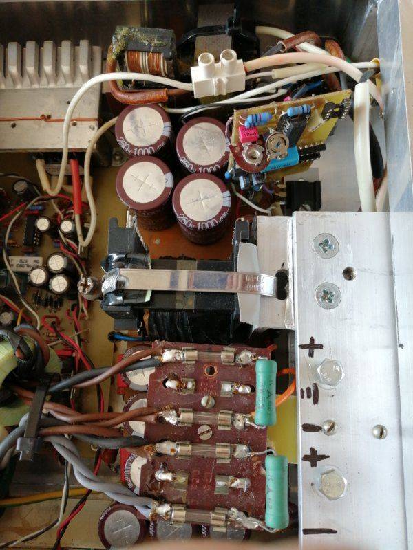

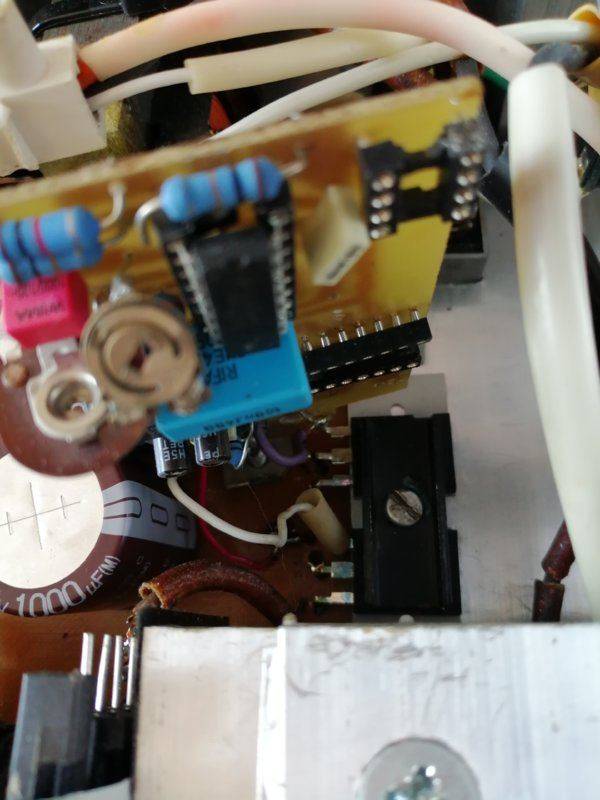

Maybe you all got upset for me not providing my pictures which if they are so necessary I can do, although you can take my words at their value when I said the whole smps is a bit crude, rude and unprofessional.
basically I would be happy to find a way to squeeze out the best results from this one without major modifications because I feel that this being my first fully functioning high power smps is sort of a done deal and I wouldn't like to go over it once more, since I have done it already so many times.
the large caps are mains filter caps, the vertical pcb with the Ic's on it is the gate driver module, the wires attached to the IGBT's are gate drive wires the other power leads are soldered to pcb traces on the main pcbthose traces then go to the smps traffo, seen in the pic.then there are bridge rectifiers after the traffo and 12 capacitors for smoothing, after that the DC is fed through fuses (seen on top) to the amplifier boards.
Tried to keep the switching traces short but in the future will have to still improve on that.

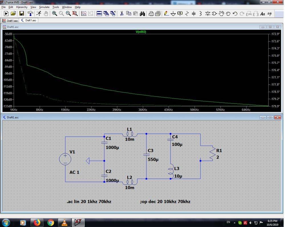

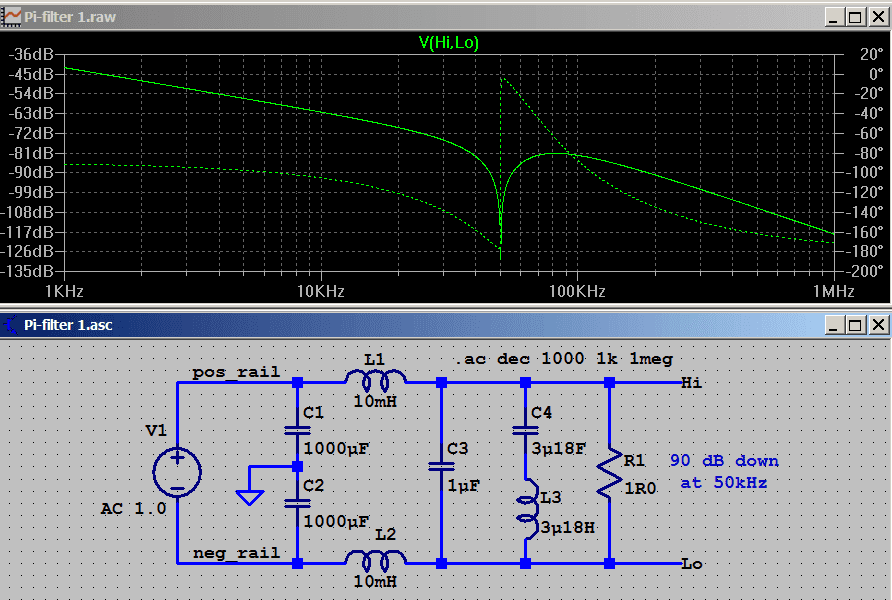

I would experiment with a Pi filter between the smps as it is and the amplifier. The Pi input and output would have ceramic and polyester capacitors, the Pi output also needs one electrolytic. The Pi filter would use toroidal inductors. Such a circuit might connect to the existing fuse holders, and have duplicate fuses. Only the Pi filter ground connection needs to be arranged. If it improves things sufficiently you can try removing some of the extra electrolytics from the SMPS output and replace them with the Pi filter components.
hmm , typically i see this Pi filter being implemented as part of the smps output stage , so it comes in between the filter caps , are you saying I could achieve the same result putting the filter on the already filtered DC "rails" that go to the amp boards?
Technically it should because the parasitic waveform in any case is AC and a filter should work with AC anyhow, right?
if this would turn out to be successful it would help me to know how to make better smps circuitry in the future. after all this is exactly the reason why many "audio people" fear smps as a power supply more than the devil fears the cross... :D
although modern well made smps are I think superior, at least from my own experiments the audio seems more dynamic , probably due to the fact that on higher power levels the supply voltage sags much less on demand than it would with a linear supply, but this is beyond the thread.

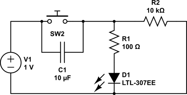

Here's a circuit image compliments of stackexchange.com. C1 connected to SW2 terminals. Only 0.1μf instead of 10 μf.
242508
in my case as it's a half bridge I would have to put the cap across each of the two switches ?
I wonder how does the cap reduce the switching spikes? because when the switch is closed it seems it is charged by the potential across the switch contacts then as the switch opens the cap gets discharged through the switch and as the switch closes (presumably causing the spike) the spike is absorbed as the charging current of the capacitor?
I see no way that a cap across a switch will reduce supply output noise. If anything it will increase switch power due to discharge of cap when switch closes.
Adding snubbers to switches and (bridge) diodes is a common practice when it is about excess EMI (after the layout-cleanup is already done). It is just that for this device it would be extremely hard to pinpoint the actual source of the spikes, since everything has coupling with anything else.

Fundamental output noise needs to be removed by a Pi filter stage at the output. That filter needs input capacitors with very low ESR. The Pi input capacitor ripple current flows through the series resistance of the input capacitor, alternating between recharge and discharge at the SMPS fundamental frequency. That alternation doubles the AC ripple voltage on a simple SMPS output, and leads to a lower noise Pi filter solution that removes switching noise.
Well @Baluncore explanation sounds reasonable to me that an extra capacitor will be an extra current sink to charge and then more current to discharge as the switch opens.

Sound like the Pi filter might be worth a try and the most reasonable choice for me given remaking this smps would essentially mean building a new smps.
Got some good proven Pi filter schematics with part markings etc? @Baluncore, thanks.

How much experience do you have with SMPS design?
You changed from FET to IGBT, did you adjust or consider dead time? (IGBT's do not switch like FET's)
You have a 1uF 400V blocking cap, this is not necessary with the half bridge topology, your split supply capacitors already do this for you.
Looking at your build I would bet you are dealing with common mode noise, your IGBT collectors are connected to the heat sink and I don't see a shield layer + Y caps to to provide a current return path back to 400V ground for the currents that want to flow through those capacitance's during switching edges.
Coils won't help, you'll need to shields and Y caps to start with.
Also if your scope cannot resolve the high frequency noise then you are basically working blind.
No regulation is fine, I assume you are running at or near 50% duty so you basically have a fixed ratio DC-DC and the output will sag a little with load, totally fine for audio.
However there appears to be zero protection in the SMPS section, short of some quick bench tests I would not use this as a long term power supply, esp not unsupervised!

@Baluncore I would be interested in some good Pi filter schematics that I'm sure you know of that would best suit my application here given the 50 Khz frequency and DC voltage that I gave which is around 85-0-85v DC a split supply.
thanks
Get a copy of LTspice. C1 and C2 are your existing supply reservoir capacitors.
L1, L2 and C3 are low pass filter. C4 and L3 make a trap, tuned to 50 kHz.
244323
Likes artis and jim hardy

artis said:
first have to get hold of the inductors and capacitors,
You missed my first point. FIRST get a copy of LTspice.
There are simple modifications to that circuit that increase rejection. You cannot quickly test sensitivity to value in hardware. What if you split C3 into two 0u1F ceramic caps and ground the centre? What if you change the trap to 31u8F with 318nH, then how does the Q of the notch change, for 50kHz, but also for harmonics. What if you wind L1 and L2 on the same core to cancel the supply current induced field?
artis said:
the psu filter caps are electrolytics but the filter caps should be bipolar.
Why? They are polarised by the power supply voltage. What do you actually mean by filter caps. You must be more specific.
artis said:
I wonder which ones better, polypropylene, polyester or other or there is no difference?Probably a lower ESR is better?
You can test ESR and capacitor loss with spice. You waste time asking silly questions when spice can answer questions quickly, and put real numbers on the answers. There is no “better” unless you specify a numerical requirement.
artis said:
PS. I have some ferrite rings I guess I'll have to find a calculator to know how many turns I should wind to get 10mH as well as 3.18uH. problem is those rings have no markings so I don't know the ferrite material specifically
Why waste time on unknown parts. Design a solution and specify a core, or measure the core and model it in the circuit with spice. When you build the inductor, if the core gets hotter than the wire then you have the wrong core material. If the wire gets hotter than the core then use thicker wire with a more expensive core. If it all gets too hot, you don't know what you are doing because you have not modeled the circuit. If it stays cold you have invested too much buying big cores and winding them with over-thick wire.
Either you engineer minimum circuits that work, or you cut and paste circuit blocks without understanding the costs and implications.
