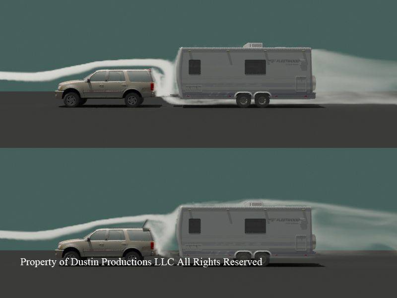

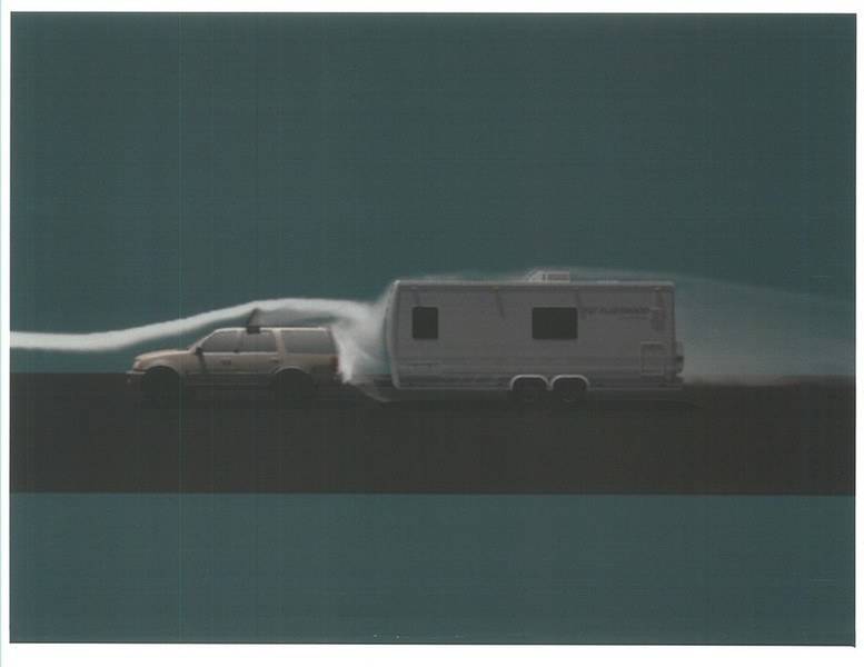

Does anyone have any idea of what kind of forces a 6 foot wide, 3 foot long wing would see angled up into the wind at say a 45 degree angle or more at say up to 70 mpH?
I'm guessing we will want the answer in pounds, perhaps FT/Pounds.
Ballpark numbers on horizontal, vertical and or down-force and or lift.
Just need a general idea for discussion purposes if you can please. Comparisons in laymen terms would be very useful.
My guess is that such a plane would experiences forces similar to a football tackle between some 120 lb kids. Not very useful, very subjective but it gets an image across hopefully.
Let's put it this way, if you have ever built something and sat on it, pulled on it, or jumped on it to test it before mounting, then you know what I mean. We are talking backyard engineering where one can just throw more parts and material on something until it feels right. Just short of the "hold my beer and watch this" approach.

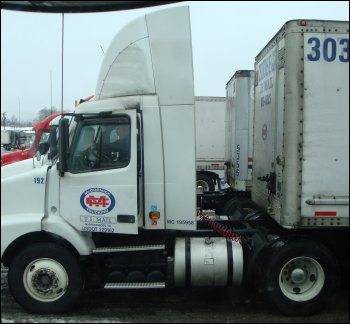

@kach22i -- That air dam on the SUV doesn't look like it's placed correctly. It sure doesn't seem to be doing much with the airflow over the trailer. Shouldn't it be placed at the back of the SUV, more in line with how the air dams on tractor-trailers work?
http://www.truck-drivers-money-saving-tips.com/image-files/air-resistance-drag-dsc09127.jpg

Berkeman, I think they placed it correctly load wise, which is perhaps in conflict with aerodynamic needs.
In other words, the vertical force is downward and mid-way in the wheelbase of the tow vehicle.
If the vertical load is aft of the center of gravity it will lift the front wheels and steering gets light - way too light.
I've towed my hovercraft around a bit, once I tried loading it backwards with most of the weight on the tongue - that was a disaster in the making.
I think the rule of thumb with the sub 1,000 lb load I had was about 50 lbs on the tow hitch ball/tongue. I always like a little more weight because I was afraid of it lifting off the ball.
The double axle of the trailer/camper in the photo far above will still want to see-saw a bit, best to have your tow vehicle as sure footed as possible.

Well, as it's placed right now, it looks like it is of no aerodynamic benefit to the trailer, and a significant aerodynamic hindrance to the SUV. I hope nobody pays any money for something like that.
To avoid the loading and downforce issues on the SUV, and help streamline the SUV+trailer pair, just run a taut tarp from the back of the SUV to the top/sides of the trailer. Make it so that it can flex for turning, but is taut enough to re-direct the airflow in straight-line high-speed driving so the front of the trailer is protected.

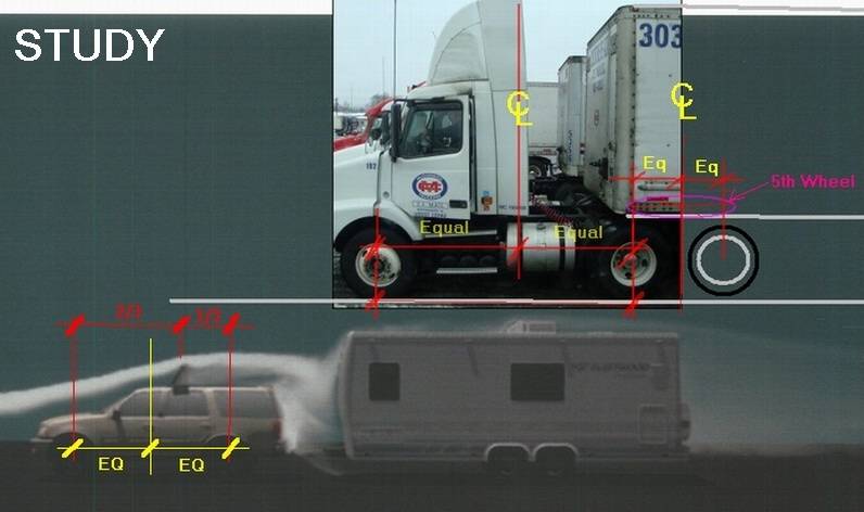

I'm not here to argue the merits or efficiency of the design posted as I feel it's a distraction from the original goal stated.
I am more than willing to analyze it however in a effort to understand it.
I stated earlier that I thought the diverter plane was mid-point of the wheelbase or center of mass/gravity, this turns out not to be quite true (unlike the Tractor Trailer design). And as a result I'm starting to really not like it, although without a smoke flow image without the air diverter to compare to I'm hesitant to condemn it completely as of yet.
To make it clear, I'm not attempting to design or promote anything, just curious about the scale of forces involved.
It seems to me now that there could be more lot going on than I first thought, and this is not a simple vector of forces with equal reaction math problem. I mean it could be simple, not asking for axle loads or anything, right?

I found a sister image to the opening image - I think.
https://www.rv.net/forum/index.cfm/fuseaction/thread/tid/28963857/print/true.cfm
