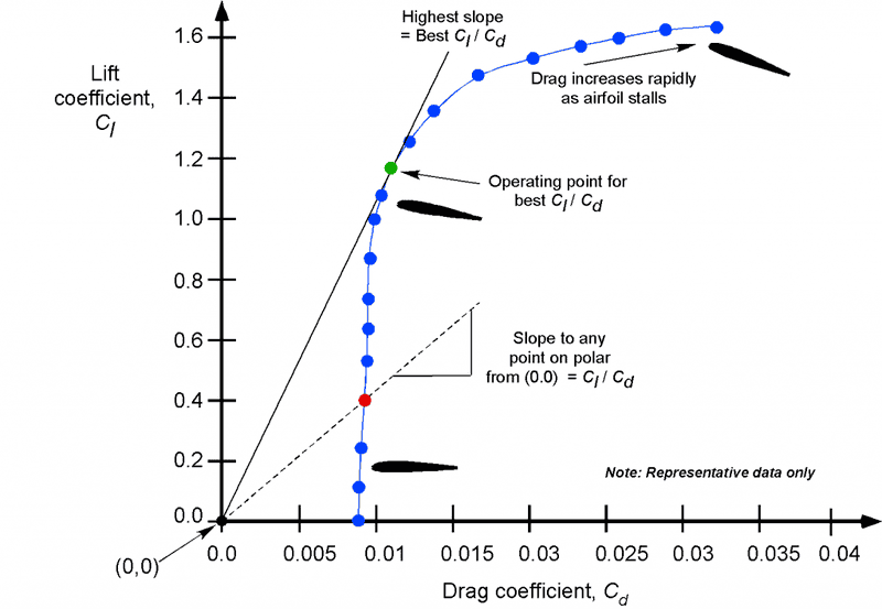

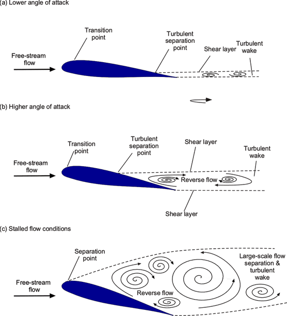

"Flow Separation on an Airfoil
Boundary layer separation from a body, such as an airfoil section, as shown in the schematic below, can have significant consequences, including a large increase in drag and a substantial loss of lift.
This outcome is because the rear part of an airfoil creates an adverse pressure gradient, which becomes increasingly adverse with an increasing angle of attack.
At low angles of attack, the boundary layer can withstand this gradient, reaching the airfoil’s trailing edge or separating just before that point. However, as the angle of attack increases, the more severe adverse pressure gradients cause the flow to separate at a shorter downstream distance, so the separation point moves forward.
Eventually, flow separation occurs near the leading edge, and under these conditions, the airfoil is said to be stalled.
The turbulence produced in the separated flow region and wake is also a source of unsteady aerodynamic loads and buffeting on the wing.
Indeed, a characteristic of stalling the wing of an aircraft during flight is the creation of unsteady aerodynamic loads and buffeting transmitted to the airframe, warning the pilot of an impending wing stall."
