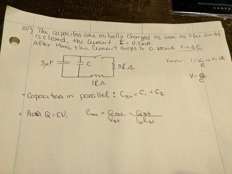

If so, how do I go about finding the total current?
See photo above.
See above.[/B]
Is that what you are asked?Kelsi_Jade said:If so, how do I go about finding the total current?
You are given two values for the current at different times. You'll want to use them at some point...Kelsi_Jade said:Here is what I have so far. Am I going the right direction?
Yes, so you have a basic RC circuit (resistor - capacitor circuit).Kelsi_Jade said:Well, since the resistors are in series you can combine them to equal one resistor with a resistance of 3+1= 4kOhm.
The capacitors in parallel would equate to one capacitor with 3+C= (3+C)microFerrads.
Current with respect to time would be = Q/Δt ?
