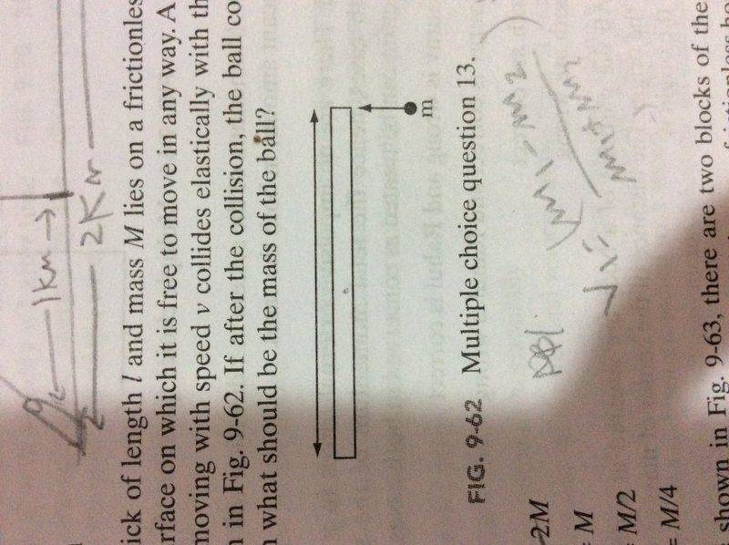

A stick of length L and mass M lies on a frictionless horizontal surface on which it is free to move in any way. A ball of mass m moving with speed v collides elastically with the rod at one of its extreme end( as shown in the figure). If after collision ball comes to rest, what should be the mass of the ball?
a) m= 2M
b)m=M
c)m=M/2
d)m=M/4[/B]
I have attached a pic of the figure
