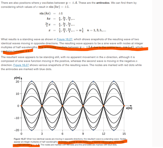

For this,
The two statements highlighted do not seem to agree. I think the first statement highlighted is referring to A as initial amplitude (which we can denote ##A_i##) of the traveling waves before there constructive interference to form antinodes with an amplitude 2A and nodes of an amplitude 0. Where I think the second highlighted statement is referring to when A is the resultant amplitude of standing wave which we can denote ##A_f = 2A_i##.
Is my understanding please correct?
Many thanks!
Many thanks!
I believe you are right. There is also the very first sentence of that extract, which also says ##\pm A##. I assume A is defined in some preceding text, so both the A references should be 2A.
Likes member 731016
Great, thank you for your help @haruspex!
