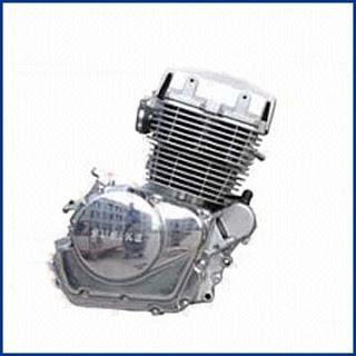

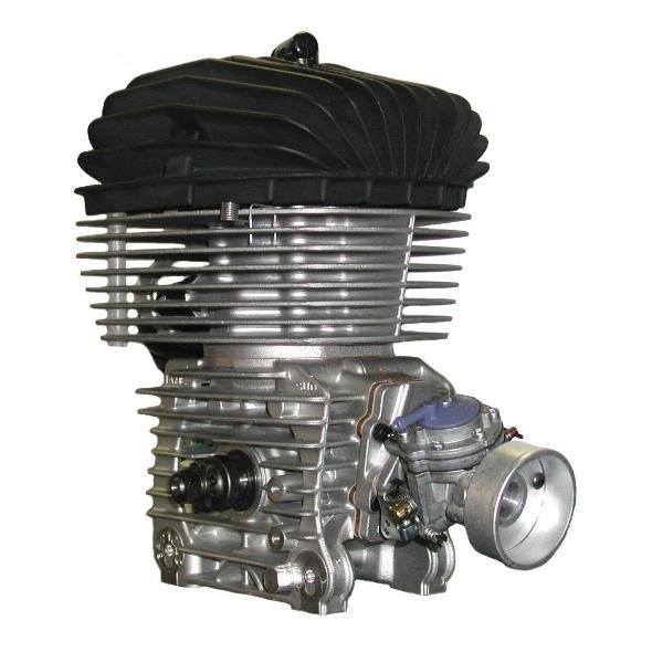

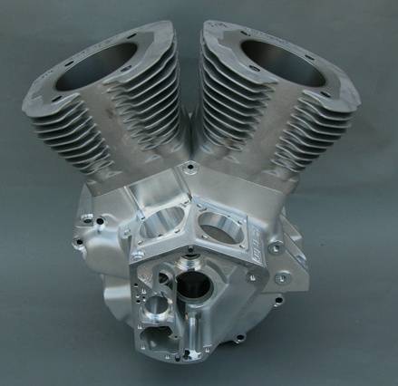

In general, air cooled engines have fins on the cylinder head and block to accomplish exactly what I think you are getting at.
Examples:
Examples:
i thought they only increase the area of contact.
