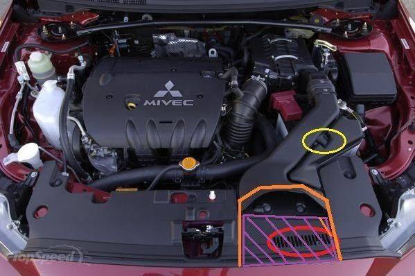

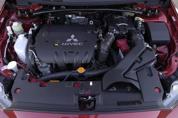

In an attempt to design and construct a new less restrictive engine intake system I've run into a number of questions I am not yet able to answer.
Main Goal: To produce a new intake system and associated plumbing associated with it.
Intake in Question:
Calculations:
Minimum Intake Width: 3'' X 3'' (9 Sq. Inches)
Displacement: 2.4 liters (~1.2 liter volume intake per revolution assuming counterbalanced pistons)
RPM: 6000
Volume / Min: (1.2 X 6000) 7200 liters / min
Cubic Feet / Min: (0.0353147 cubic feet / liter) 0.0353147 X 7200 = 254 cubic feet / min
Cubic Feet / Sec: 4.24
Feet / Sec Through Intake: 4.24 / (0.25' * 0.25') = 67.8 ft / sec
Questions:
1 . Correct me if my math or assumptions are wrong, but 67 ft/s seems like an awfully turbulent speed for such a small pipe and if widened, would decrease resistance / parasitic drag, no?
2. Would applying a dry teflon grease to the new piping decrease turbulence significantly?
3. Should the intake be as wide as reasonably possibly or am I ignorant to some physics going on here? (ie. Pulse Resonance, intake velocity leading to turbulent swirling in the piston draw, etc.) ( I feel that the air intake rate into the piston would be so quick that any initial speed would be negligible.)
Again, suggestions / help / criticism are welcome!

I guess you are looking at the inlet duct to the airbox(filter housing). I don't think enlarging a 3"x3" duct will reduce the inlet restriction any. A 67.8 f/s intake charge is not very high speed, and should not net any real pressure drop compared to the filter, throttle body or intake port.
From the picture, I would look at the area where the air gets to the funnel going into the square duct going to the airbox. It looks like it has to go in the grill then up through those little slots in the plastic cover over the radiator. You might want to run the inlet duct all the way to the grill, or other forward opening. Try to minimize the direction changes while you are at it.
If you can get rid of part or all of the left front headlight assembly, that would make a nice spot to draw air from.
Hood scoops are another option.
The easiest thing to do, would be to cut a bigger hole in the plastic cover where those slots are.

In the picture below, I have shown with a red circle the possible restriction for cold air. The slots I mentioned before there are the only way for cool air coming in the grill to go up before it gets to the radiator or condenser, and into the funnel to the inlet duct. My suggestions for this car, from looking at the picture below are to.
1: Block off the passage to the resonance chamber that is circled in yellow to help increase noise, and possibly help airflow a little.
2: cut out the purple shaded area to let air come from the grill area into the inlet duct, and
3: Seal off the orange outline around the incoming air to the hood by building it up with some kind of compressible foam rubber to keep hot air out.
Depending on what it looks like under the area that is to be cut out from the front panel, it may be a good idea to put a deflector of some sort to help direct more air upward and into the inlet. be careful not to block off too much airflow to the radiator though.
The resonance chamber is there to prevent flutter of the airflow in the inlet duct. Those oscillations may choke the duct airflow and create flat spots at some critical speed. Any extra noise will be accompanied by a reduction in the smooth flow of air. If you want noise it would be better to modify the exhaust.
It will get enough air as it is without a deflector to ram air. Why might you want hailstones, small rocks, small birds and big insects to be directed up into your clean air intake?
The resonance chambers are there mainly for noise reduction. I doubt an opening in the side of a smooth duct will increase airflow. The noises they cancel out are usually not caused by flutter, but the natural frequency of the duct combined with the throttle blade turbulence, and the valves themselves. I don't know if you noticed, but in my previous post I had stated that you may gain or lose a tiny amount of airflow by doing so, so I am not really suggesting it as a performance mod, more of a sound thing. The duct is plenty big enough to support the airflow needed with or without a little flutter and have far less pressure drop than any air filter does anyways. Increasing exhaust noise is more expensive and easy to get dreadfully wrong, leaving an annoying drone at cruise speed.
