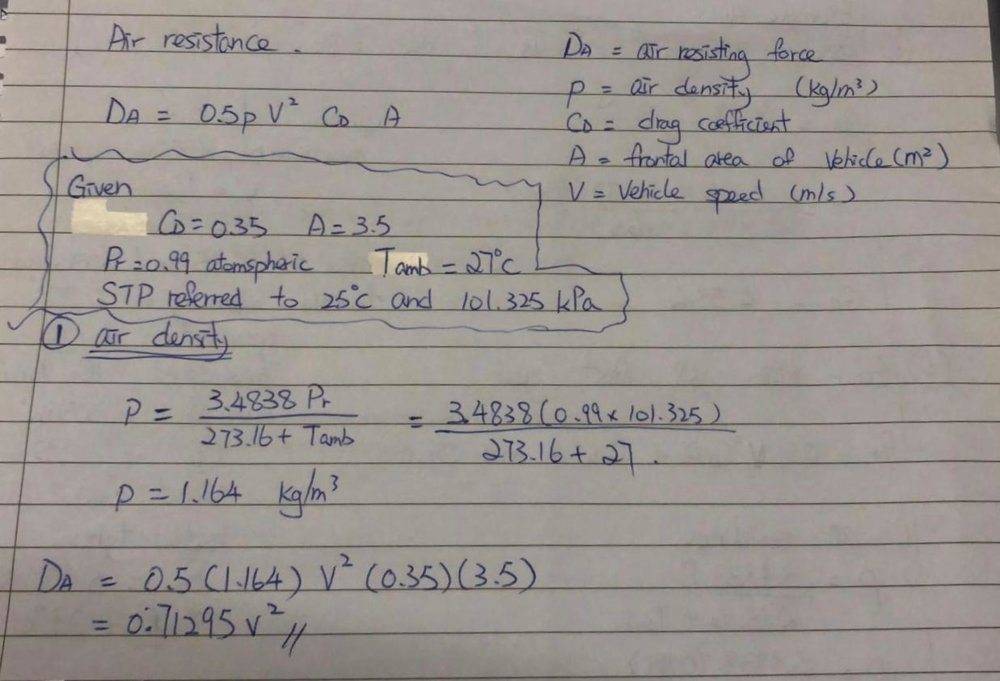

arescarmen
is it go wrong at air density?
air resistance= 0.5 p v^2 C A
242936
I checked the answer, and it is not correct.
Is it something wrong?
Welcome to the PF. :smile:
What exactly is the problem statement?
