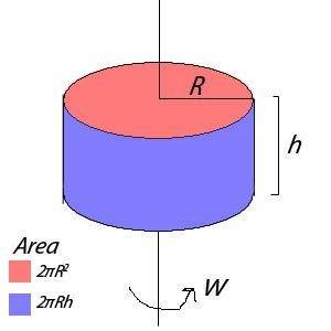

I am interested in the problem of air resistance on a cylinder rotating about its axis (axis of rotation is through the flat parts).
I used the drag equation and substituted the "cross-sectional" area as the area that's rotating at R (if R is the radius of the cylinder) so it would be the circumference multiplied by the height of the cylinder.

I have discarded the drag equation for the cylinder because I have realized that there is no "pushing" against the air, rather surface boundary interactions. Now I am not really familiar with shear stress calculations but I have tried something which goes like this:
Wall Shear Stress: [tex] \tau_w = \mu \frac{du}{dy} \right|_{y=R} [/tex]
where, [tex]\mu[/tex] is the dynamic viscosity, [tex]u[/tex] is the flow velocity parallell to the wall and [tex]y[/tex] is the distance to the wall.
So I looked at it kind of backwards, rather than the fluid is moving, the wall is moving, so the distance to the wall is from r=0 to r=R (radius of cylinder) and the flow velocity would be the tangential velocity at r=R. So we have [tex]v_t = w*r[/tex] and a derivative with respect to r would give: [tex]\frac{du}{dy} = w[/tex]
Now we have: [tex] \tau_w = \mu w[/tex]
The force is related by: [tex]F = \tau_w A[/tex], where A is the cross-sectional area
So the cross sectional area involved of the cylinder would be the the top, bottom, and the sides. (see attachment picture)
For top and bottom it would be: [tex]2 \pi R^2[/tex]
For the side it would be: [tex]2 \pi R h[/tex]
so the final force equation boils down to: [tex] F = 2 \pi R \mu w(h+R)[/tex]
This is great because [tex] \mu [/tex] is known.
Now it seems kind of strange to me that the shear stress is the same for all points of the cylinder even where the tangential velocity of the surface is lower. So far the results of this equation compared to the previous one give me higher terminal velocities (2x, up to 10x) - which is what I would expect. Can anyone tell me if I am wrong/right?

You are correct that the drag equation is really derived for the different case of flow going past a body, not for a rotating body. In your next post, you were on the right track I think when you mention the wall shear force of
[tex] \tau_w = \mu \frac{d u}{dy}. [/tex]
In polar coordinates, the derivative transforms to
[tex] \tau_w = \mu \frac{ d u_\theta }{dr}. [/tex]
The flow field between two rotating cylinders can be solved for exactly in the fluid equations. I've got a book by White, "Viscous fluid flow", page 103, which gives a good reference. This analysis assumes the cylinders are infinitely long and the system is in steady state, i.e., it has already started spinning and now nothing is changing with time. In the limit that the outside cylinder goes to infinite radius and zero angular velocity, it gives the proper velocity that you're looking for. The solution from the book is just
[tex] u_\theta = \frac{R^2 \omega}{r} [/tex].
This expression provides
[tex] \tau_w(R) = \mu R^2 \omega (-\frac{1}{R^2}) = - \mu \omega.[/tex]
The minus sign just indicates the force is in the clockwise direction, assuming the cylinder rotated counterclockwise, which makes perfect sense of course. Then, integrating around the circumference, for the entire cylinder of length L and circumference 2 pi R, you just get
[tex] F = \int - \mu \omega R d\theta dL= - 2 \pi \mu \omega R L .[/tex]Note -- sorry I made a mistake writing the last night when writing this. Just fixed it -- the answer actually comes out pretty similarly to your answer you already had.
This analysis doesn't include the drag from the top and bottom of the cylinder, which would have to be calculated differently. You were right before to notice an intuitive issue due to the fact that the top and bottom of the cylinder have a velocity that varies with distance from the center axis. If the cylinder is long, then those sides shouldn't matter too much. Still, this is a good starting point, since you have an exact solution for this case.
You might be able to account for the top and bottom by considering a different case with a rotating disk, and then adding those contributions to the current case.
