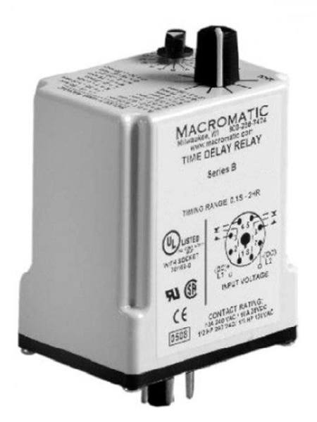

You may want to look into Time Delay Relays.
This image from http://www.productsforautomation.com/macromatic-tr60526-interval-time-delay-relay-p/tr-60526.htm
Likes Pilotman Ray
