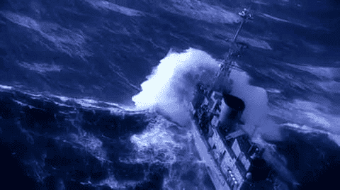

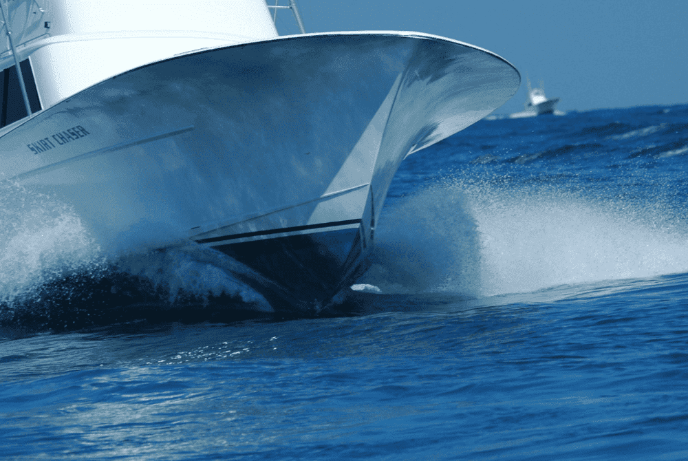

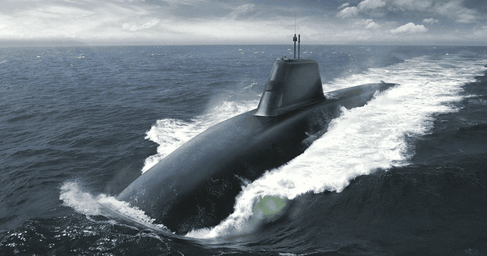

Most posts in this thread discuss drag. Stability was mentioned. I also want to point out that keeping waves off the deck is another important factor. Despite bulbs under the water line, they are flared above the water line to deflect waves to the side.
versus
Of course, modern submarines find it unnecessary to be on the surface in heavy weather.
Come to think of it, in the second picture, the conning tower can be considered the pointy part and the main hull the sub-surface bulbous part. Just broaden the definition of which part is the bow.
Likes Klystron, Lnewqban, BillTre and 1 other person

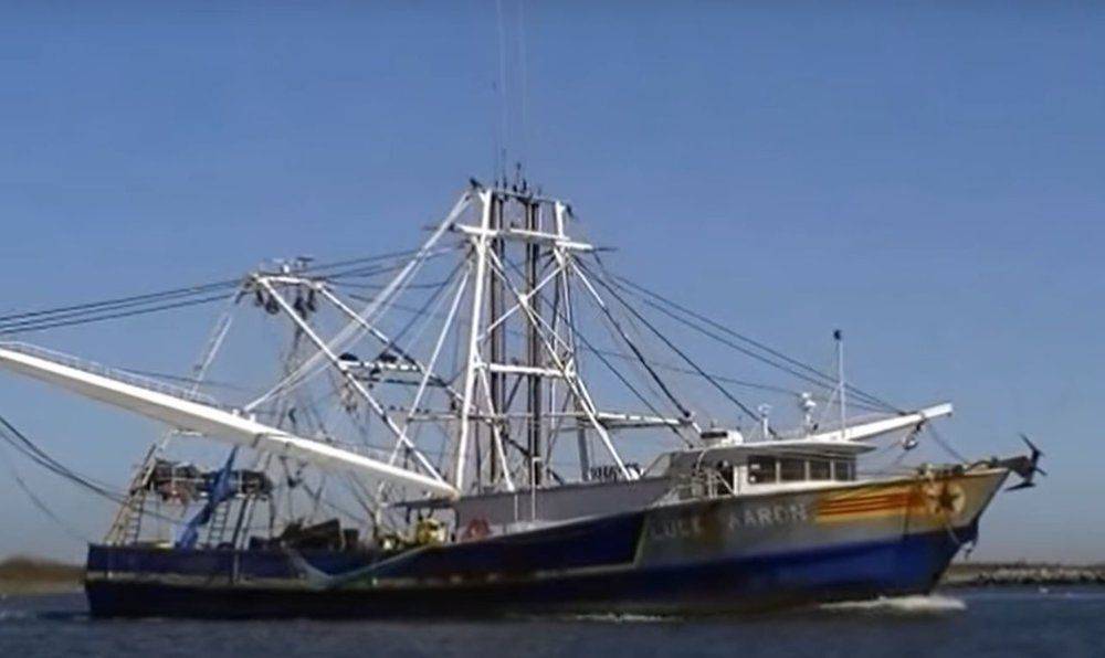

On the Louisiana gulf coast most shrimp boats like that pictured below also have the pointy bow design. I'm not sure if it is simply tradition or the ability to handle rough water favoring this design, but it is nearly universal in the Louisiana shrimping fleet. Fuel economy IS a big deal to Louisiana shrimpers, as they often plan their routes to maximize their catch relative to their fuel costs rather than per unit time. But fuel costs didn't become a large factor in their decision making until about 20 years ago, and most of their boats are older than 20 years old.
It would be interesting to know the trade-offs in hull design when navigating at angles more oblique to the prevailing current. It would also be interesting to estimate the relative drag of the ship itself compared with the shrimping nets and associated gear. In the last two decades, shrimpers have had an increasing emphasis in catching shrimp as close as possible to their home port. Most boats I see while fishing spend a lot more time under power with their nets down catching shrimp than with the nets up motoring from the port to their shrimping spots. Of what use is a more efficient hull design if most of the fuel is spent dragging the nets around?
I do know that a major point of emphasis for both recreational fishers and commercial shrimpers is being able to operate in shallower water. The shrimp boats that can run back and forth in shallow water closer to the beach catch a lot more shrimp per gallon of fuel some months of the year than those forced to operate only in deeper water. Likewise, shrimp boats that can run in many of Louisiana's shallower bayous and inshore waters also have advantages.
Correct me if I'm wrong, but I think the "pointy bow" design can usually operate in shallower water than the bulbous bow designs, for boats of comparable length and capacity.
Maybe yes, but not necessarily yes. The draft of that boat in the picture is likely 5-8 feet with the deepest part mid-ship. That's enough for a bulbous extension that does not increase the draft.
That boat in your picture is almost big enough for a bulbous retrofit IMO. It is an economic trade-off, efficiency versus initial cost. It might be a good business opportunity for an enterprising marine architect down near the gulf to design something economic enough to be attractive to shrimpers. If it could be mass produced and bolted on, the cost could be lowered. Load at the attachment points might be the difficult part, especially for the running aground contingency.
That might make sense for boats and operations on the scale of Omega Protein, but most mom and pop shrimping operations are not going to be able to invest in fuel efficiency improvements that may or may not pay for themselves over a 5-10 year period. Most of the time, they are simply trying to pay the bills this year and still be in business next year. They already have a bunch of "cheap" tricks to reduce fuel costs - like mooring to a fixed object, letting down their nets in the current, and catching shrimp without any fuel in certain tidal conditions.
In contrast, the Omage Protein ships travel much larger distances from port, have ships large enough to show larger benefits, and are owned by a company with the wherewithal to make an investment that might take 5-10 years to pay for itself. Still, the idea may seem like snake oil to them.

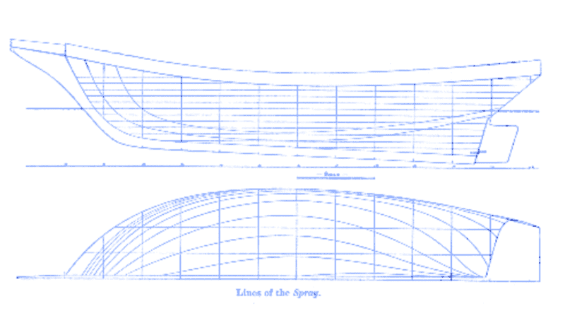

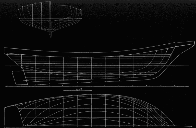

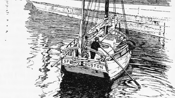

Joshua Slocum bragged that he sailed his boat, Spray (double-ended, full keel), from Perth Australia to the desired port in Africa without ever touching the steering wheel. I think he exaggerated, but nevertheless his feat was remarkable.
Joshua Slocum was clearly a great and resourceful sailor. He was also a showman and loved the idea of being a hero figure. His story of 'fixing' the errors in his ephemeris tables and washing out his ship's clock when the sea got into it sound a bit far fetched. i don't think he would have been fun to travel with! Fab book though.
Likes anorlunda

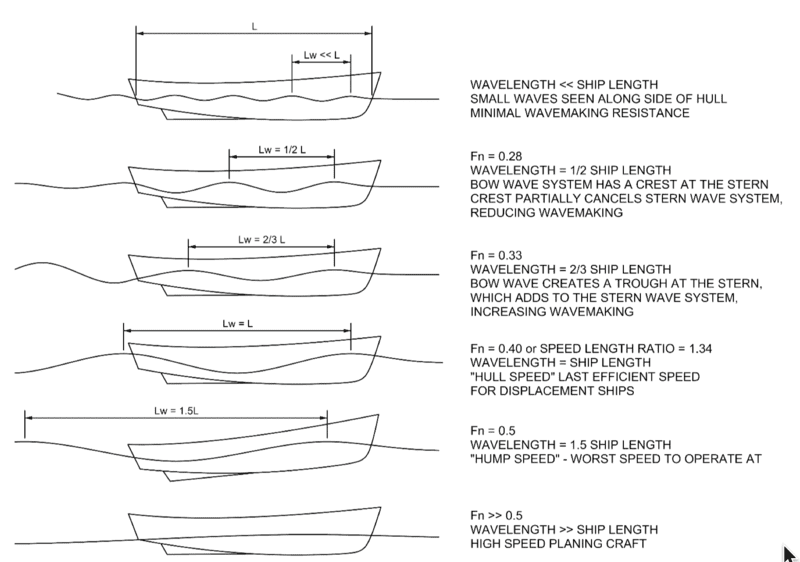

The bulbous bow is an interesting thing.
The idea is to create destructive interference of waves, the bulb creates a trough where the bow meets the surface, thereby canceling the bow wave. So there is energy lost by creating the initial trough, but this is offset by the much lower wave resistance along the rest of the hull due to the canceled bow wave.
It is very important to note that the bulb is designed in conjunction with the rest of the hull to do this at one specific speed. Which is why you see it a lot on ocean crossing vessels that steam at essentially constant speed.
So a bulbous bow makes no sense on a boat that changes speed all day (ie most recreational and near shore boats).
Likes DaveE and Dr. Courtney

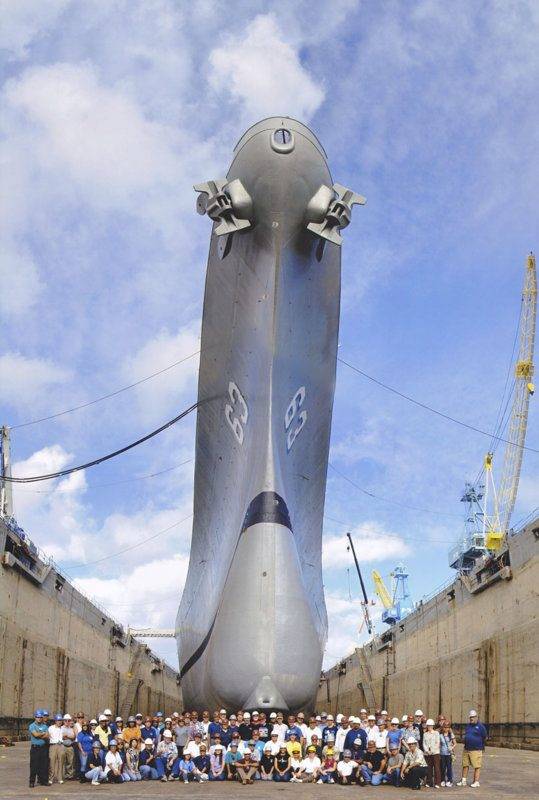

Bulbous bows appear to have started showing up in the late 30s. When looking at dreadnought design at the turn of the last Century they were symmetrically pointed bow and stern. Even battleship designs prior to the Iowa class, the bows were "clipper bows" with mild flares. When the Iowas were designed they took the 600+ feet length of the South Dakota class and lengthened the ship over 200 feet. Most of that 200 was a great increase in both length before getting to turret #1. There was some increase amidships giving room for twin funnels and more AA emplacements. The bow had a modest bulge below the waterline ad a very sharp, almost razor-like stem post. The result: 7 knots from 26 to 33 enabling these 900 foot monsters to keep pace with the fast Essex Class carriers of the day.
Likes berkeman
