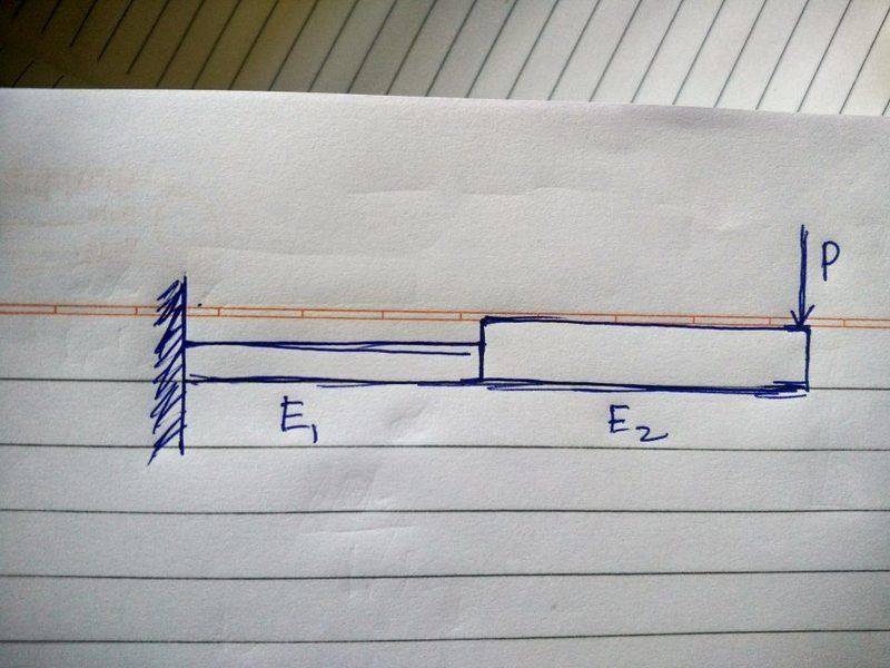

I have to calculate Airy's stress function for a cantilever beam made of two different material along its length.
The young's modulus of the first half is E1 and E2 for second half. The beam is made such that these materials are joined to each other one after other along its length.
At the interface, there will be a force balance and same displacement for both the beams.
How will I calculate the forces at the interface?

I would like to add one more detail to the problem. The areas of the two beams are different. Because of this, there will be a discontinuity in stresses at the interface however the force would be same. So i feel that there will be a redistribution of stresses of some sort, I am not sure.
How can i solve this problem taking into account the redistribution of stress?

We know the Youngs modulus and all the dimensions of the beam. We know the force applied. We have to find airy's stress function, stresses, strains and displacement functions. If i could solve for stress, i would be able to solve for the rest of them.
Please do a proper drawing of the connection zone between the two beams sections and post it for us to discuss .
By treating the total beam as two series connected cantilever beams you should be able to get the stress, shear and deflection data you need for your final calculation.
I've processed your sketch to make it a bit clearer .
Realistically I don't see how you can properly obtain the stress distribution at the junction of the two beams without using numerical methods .
Just to get an approximation you could assume some distance either side of the joint where the beam stresses revert to having a simple distribution and then sketch in best guess for distribution in the transition area .
There will be a stress concentration to consider in the corner of that abrupt step .

Yes, actually this is the actual problem i am working on. Thanks for your help so far.
I have assumed that the stress at the beam interface with larger area will be the same as the beam with smaller area. After going the distance equal to its thickness(according to St, Venant principle), the stress in the beam with larger area will become equal to the stress calculated by the basic beam equations.
There will be no change in stress distribution in the beam of the smaller area.
The reason for this assumption is that if we change stress distribution in the beam with smaller area, the moment of these stresses are not coming to be equal to the moment at that section. So i assumed that there will be no stress change in the beam with smaller area.
Is my assumption correct?

Yes, upto some degree. I managed to calculated the stress field at every position of the beam. However there will be some highly non linear stress field in the vicinity of the interface. I am pondering about the same, how to calculate the non linear stress near the interface...
any thoughts?
Basic variable section beam theory does not help you solve this problem at all .
As I said in post #14 :
Let us look at the approximation method first .
Start by drawing out the joint area of the two beam sections neatly and large size on graph paper . Sketch in you best guess of the stress distribution .
The change at the interface is instantaneous with the stress profile having a vertical line at the interface. It is as though there are two individual beams connected in series at that junction.
