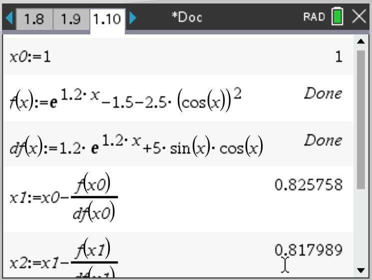

Alexander asks:
Apply three iterations of Newton's Method to find an approximate solution of the equation
$\displaystyle \mathrm{e}^{1.2\,x} = 1.5 + 2.5\cos^2{\left( x \right) } $
if your initial estimate is $\displaystyle x_0 = 1 $.
What solution do you get?
Mathematics news on Phys.org
@Prove It answers:
Newton's Method solves an equation of the form $\displaystyle f\left( x \right) = 0 $, so we need to rewrite the equation as
$\displaystyle \mathrm{e}^{1.2\,x} - 1.5 - 2.5\cos^2{\left( x \right) } = 0 $
Thus $\displaystyle f\left( x \right) = \mathrm{e}^{1.2\,x} - 1.5 - 2.5\cos^2{\left( x \right) }$.
Newton's Method is: $\displaystyle x_{n+1} = x_n - \frac{f\left( x_n \right) }{f'\left( x_n \right) } $

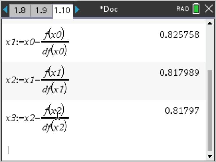

We will need the derivative, $\displaystyle f'\left( x \right) = 1.2\,\mathrm{e}^{1.2\,x} + 5\sin{\left( x \right) }\cos{\left( x \right) } $.I have used my CAS to do this problem:
So after three iterations the root is approximately $\displaystyle x_3 = 0.81797 $.
