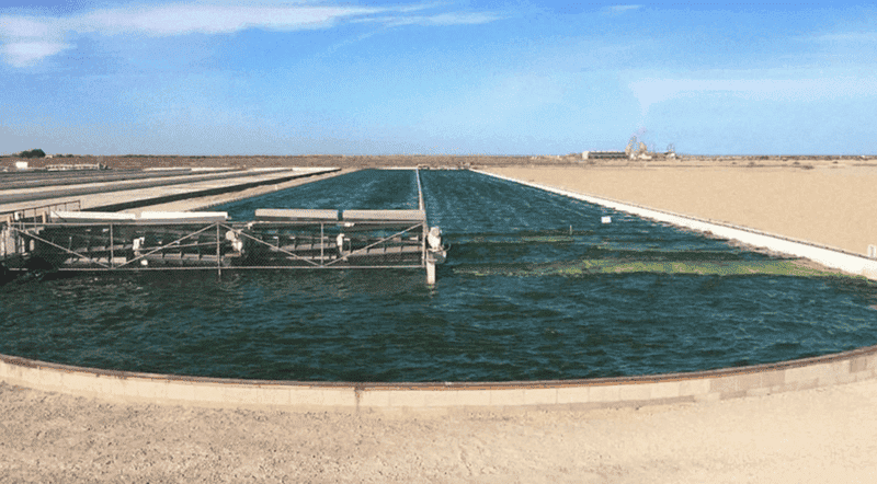

More than ten years ago I visited an algae growing aquaculture facility in an arid area in California somewhere (don't remember where).
Its function was to make Spirulina algae for food production (humans and other things).
Besides the water maintaining equipment, it was mostly an oval shaped raceway of circulating water, maybe 20-50 feet wide but only a a foot or two deep. (The color was very green and the light probably wouldn't penetrate very far.)
The water circulation (due to paddle-wheel) keeps the algae in suspension. Otherwise it would create production problems.
This looks like a cement lined pond, but it might be cheaper to just dig a depression and use a pond liner.
This would be far more efficient than a set-up that does not use natural light.
It was a big set-up for the amount production, but was economically feasible due to the prices of the product, which would be hard to get in large pure quantities by other means.
I can't see something like this having much impact on global CO2 in the air.
When it comes to making fuel, it might be economically feasible, depending on the fuel produced.
One advantage of algae is that it can be fairly easily engineered genetically (being single cells). This could lead to production benefits.

That is a classic raceway. The problem with using Spriulina and other nutritional supplments as a comparison to algae for fuel is that the end product for Spirulina sells for around $15 for 500 mg [$30 a gram]. Algae fuel needs to sell for [today] $4 for 7.2 pounds [one gallon]. It is a very different problem by two orders of magnitude.
I am still convinced that algae is key to a renewable energy future. However, we need to grow about as much algae [by area] as we do corn. That is in the neighborhood of 90 million acres.

Purity is a HUGE issue in fuel production. Firstly, most strains are not sufficient for producing fuel. And strains are being hybridized to maximize the yields. Strains tend to mutate from good producers to poor producers. So maintaining a high-yield strain is challenging. Also, algae is highly vulnerable to invasive algae species, bacteria, viruses, and parasites. These are but a few of the challenges in producing fuel from algae. Wild strains left to grow naturally will never produce enough fuel per acre-year to be competitive at the pump.
For CO2 sequestration, the idea is to do what nature has done for millions of years. Algae in the ocean absorb CO2 to grow. They eventually die and sink in the deep ocean where it is preserved by the high pressure and low temperatures until eventually turned over and buried by tectonic motion. It turns out that a significant percentage of petroleum actually has it's origins in ancient algae.
When used as a fuel, algae fuels can be carbon neutral. They can only release as much carbon as was absorbed to grow.
Due to the vast amounts of water required to grow algae for fuel production, [note the number of hydrogen atoms per molecule of biodiesel]
the only viable option I see is to grow the algae in closed bioreactors [essentially giant baggies] in the ocean and possibly large lakes. Abandoned oil platforms in the Gulf of Mexico would make excellent hubs for oceanic algae farms. And the infrastructure for fuel production is already in place.
Ocean farming also helps to reduce the problem of excess heat, which is a challenge for land-based algae farming. Open raceways like that used for Spirulina are not acceptable for fuel production. They will certainly be closed batch systems. The purity of the strain could never be maintained for long in an open. continuous production system. And even running a paddle wheel in a configuration like that could eat up most of your energy gains from the algae produced.
The key to starting an algae bloom is to dump vast amounts of nitrogen into the water. In fact nitrogen accounts of a significant percentage of the cost of farming algae. Runoff from farms and other sources rich in nitrogen such as sewage, often spawn wild algae blooms. Also, algae can be used to remediate nitrogen pollution in a controlled manner, rather than allowing wild blooms to choke off the oxygen supply for wildlife.
When I first started looking into algae for fuel, perhaps as far back in 2006, biodiesel from algae cost up to $50 a gallon to produce. I have read recently that some producers are claiming to have broken the $5 per gallon barrier.

CCatalyst said:
Well fine but take a look at this.
Algae might be a secret weapon to combating climate change
It says that algae can be 400 times more effective than trees at absorbing carbon dioxide.
Now everyone keeps saying it is difficult to scale up. But why is that exactly? Plus some people are making their own biodiesel from algae.
Making fuel from algae is fairly easy. Making fuel from algae at a price that can compete with petroleum is extremely difficult.
Most of these DIYers are probably paying $20-$30 a gallon for their fuel. :wink:
When we can compete with the price of petroleum at the pump, we can easily convert to carbon-neutral fuels from algae. It is ALL about price.
