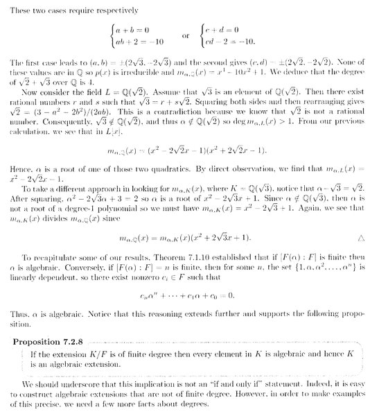

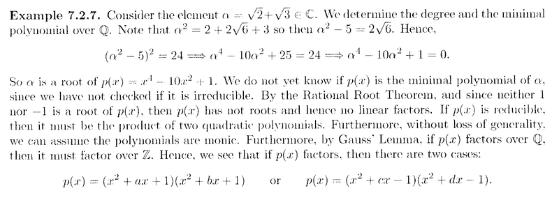

I need help with Example 7.2.7 ...Example 7.2.7 reads as follows:
In the above example from Lovett, we read the following:
" ... ... From our previous calculation, we see that in ##L[x]##,
##m_{ \alpha , \mathbb{Q} } (x) = ( x^2 - 2 \sqrt{2} x - 1) ( x^2 + 2 \sqrt{2} x - 1)##
I cannot see how this formula for the minimum polynomial in ##L[x]## is derived ...
Can someone please explain how Lovett derives the above expression for ##m_{ \alpha , \mathbb{Q} } (x) ## ... ... ?Hope someone can help ... ...
Peter
*** EDIT ***Just noted that earlier in the example we have that ##\alpha = \sqrt{2} + \sqrt{3}## is a root of
##p(x) = x^4 - 10 x^2 + 1##
which factors (in one case of two possibilities) as follows:
##p(x) = (x^2 + cx - 1) (x^2 + dx - 1)##
and this solves to ##(c,d) = \pm ( 2 \sqrt{2}, - 2 \sqrt{2} )##
... but how and why we can move from a field in which we have ##\sqrt{2}## and ##\sqrt{3}## to one in which we only have ##\sqrt{2}## ... ... I am not sure ... seems a bit slick ... ...
... indeed I certainly don't follow Lovett's next step which is to say" ... ... Hence, ##\alpha## is a root of one of those two quadratics. By direct observation, we find that
##m_{ \alpha , L } (x) = ( x^2 - 2 \sqrt{2} x - 1)## ... "Can someone please explain what is going on here ... ... in particular, why must ##\alpha## be a root of one of those two quadratics?

For the minimal polynomial of ##\alpha## over ##\mathbb{Q}## we have
m_{\alpha,\mathbb{Q}}(x)=x^4-10x^2+1=p(x)=(x^2+ax+1)(x^2+bx+1) \textrm{ or } = (x^2+cx-1)(x^2+dx-1)
in a potential splitting field. From this, the only solutions are ##(a,b) \in \{\pm 2\sqrt{3}\, , \,\mp 2\sqrt{3}\}## and ##(c,d) \in \{\pm 2\sqrt{2}\, , \,\mp 2\sqrt{2}\}##.
This has been shown by the calculation Lovett refers to.
Now ##\sqrt{2} \in \mathbb{Q}(\sqrt{2}) =: L## which leaves only the decomposition with ##(c,d)## as a possibility in ##L[x]##, because Lovett has shown in the lines before, that ##\sqrt{3}\notin L##, which would have allowed the ##(a,b)## solution also to be possible. He did this by showing that ##\sqrt{3}\in L = \mathbb{Q}(\sqrt{2}) \Longleftrightarrow \sqrt{3}=r+s\sqrt{2}\, , \,r,s\in \mathbb{Q}## leads to a contradiction.
(## \{1,\sqrt{2}\}## is a ##\mathbb{Q}-##basis of ##L##)
Thus ##m_{\alpha,\mathbb{Q}}(x)=x^4-10x^2+1=(x^2-2\sqrt{2}-1)(x^2+2\sqrt{2}-1)## is a valid decomposition in ##L[x]=\mathbb{Q}(\sqrt{2})[x]## and ##m_{\alpha,\mathbb{Q}}(\alpha)=0##, i.e. one of the factors has to be zero. Since ##\alpha =\sqrt{2}+\sqrt{3}## we can calculate which one and find the minimal polynomial of ##\alpha## over ##L##. (It has to be irreducible, since we already know, that ##\sqrt{3}\notin L##.)

Well, ##m_{\alpha , \mathbb{Q}}## is irreducible. By splitting field I meant a field extension, where it is possible to factor it. But it's sufficient here to assume a factorization. A "split" into linear factors isn't needed.
In any case it's important to keep in mind, that irreducibility depends on "where in". E.g. ##x^2+1## is irreducible over the reals, but as ##x^2+1=(x+i)(x-i)## it is not over ##\mathbb{C}##, i.e. it splits.
Decomposition simply means a factorization, usually into linear factors, but as it's not a mathematical term, I used it as synonym for factorization (here into quadratic factors). Splitting field on the other hand is a defined term. It means the field, that provides the elements (numbers) needed to split a polynomial into linear factors, to decompose it.
