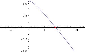

... allows a comfortable solution of the problem. The expression $\displaystyle \sqrt{1+\sqrt{2 + \sqrt{4 +\sqrt{8+...}}}}$ seems to be the limit of the sequence solution of the difference equation...
$\displaystyle a_{n+1}= \sqrt{1+\sqrt{2\ a_{n}}},\ a_{0}=1$ (1)
The (1) can be written as...
$\displaystyle \Delta_{n}= a_{n+1}-a_{n} = \sqrt{1+\sqrt{2\ a_{n}}} - a_{n} = f(a_{n})$ (2)... and the function f(x) is illustrated here... https://www.physicsforums.com/attachments/626._xfImport
There is only one 'attractive fixed point' in $\displaystyle x_{0} \sim 1.68377$ and pratically any initial value $a_{0}>0$ produce a sequence converging to $x_{0}$... Kind regards $\chi$ $\sigma$
As pointed out by IlikeSerena there is an error in (1) and the right solution is published in a successive post... sorry!...

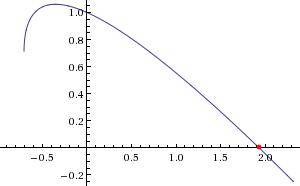

... allows a comfortable solution of the problem. The expression $\displaystyle \sqrt{1+\sqrt{2 + \sqrt{4 +\sqrt{8+...}}}}$ is the limit of the sequence solution of the difference equation...
$\displaystyle a_{n+1}= \sqrt{1+\sqrt{2}\ a_{n}},\ a_{0}=1$ (1)
$\displaystyle \Delta_{n}= a_{n+1}-a_{n} = \sqrt{1+\sqrt{2}\ a_{n}} - a_{n} = f(a_{n})$ (2)... and the function f(x) is illustrated here...
https://www.physicsforums.com/attachments/628._xfImportThere is only one 'attractive fixed point' in $\displaystyle x_{0}= \frac{1+\sqrt{3}}{\sqrt{2}} \sim 1.93185$ and pratically any initial value $a_{0}>0$ produce a sequence converging to $x_{0}$... Kind regards $\chi$ $\sigma$

Good approach chisigma, though it doesn't work because your recurrence isn't correct. It seems to produce this:
$$\sqrt{1 + \sqrt{2 + \sqrt{8 + \sqrt{64 + \cdots}}}}$$
I think a similar attempt was made in the original thread, but people noted it didn't work because you couldn't make the recurrence compatible with both the doubling at each successive level and the square roots, since they don't cancel at the same rate. I could have calculated your recurrence incorrectly, though.
The actual result is around 1.783 (by computation)
