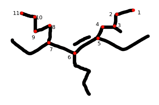

1. I made up this problem myself in order to practice. I stumped myself. I'm such a genius, I'm aware
It's basically alkene nomenclature with the E,Z naming scheme.2. Picture
See below. I've taken the liberty of already numbering the longest chain.
Without the double bond, I know that the name of this compound would be 6-butyl-5,7-diethyl-3-methylundecane.
With the double bond, I think it might be (5E)-6-butyl-5,7-diethyl-3-methyl-5-undecene. Is this right? I'm not entirely sure.

Looks correct to me
