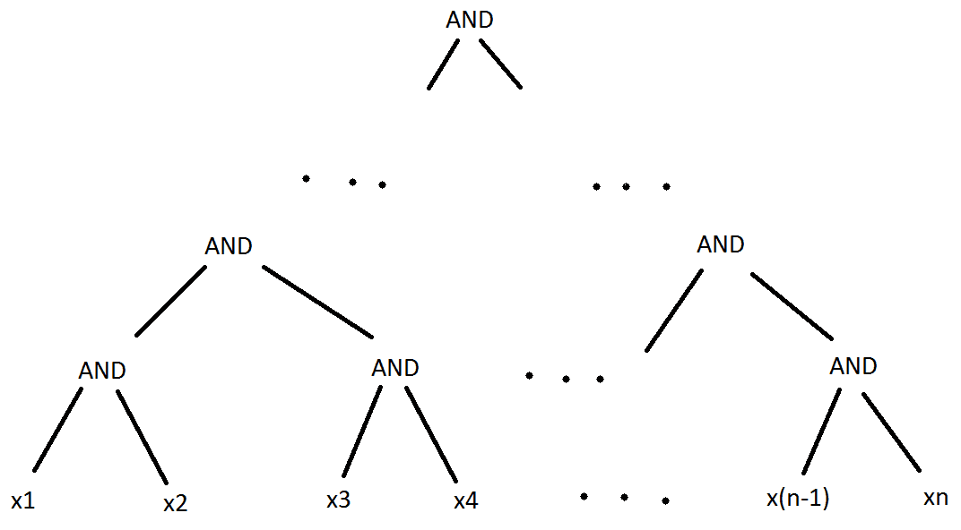

Evgeny.Makarov said:
If you break the variables in half, and those again in half and so on, then you need approximately $\log_2n$ AND gates.
In this case, are the gates in the following form?
If so, don't we have again $n-1$ AND-gates?
Correct.
We need $n-1$ AND-gates.
It's the depth that is $\lceil \log_2 n\rceil$.
You are right. I made a mistake.
Ok, nice. Thank you both for your answers! (Smirk)
