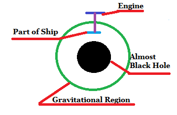

Hello,
I am new to this forum! I have only just completed my first physics class, but I like to learn about
some of the more advanced topics in physics on my own time. I was watching a video about black holes and I noticed a part of the video that stated "any matter that enters this region of space spins so fast that centripetal force tends to fling it out" (22 minutes). I was wondering, how fast is that? Could you fling a spaceship that fast? If not, if the object were near the density and mass of a black hole, but was not at the density and mass of a black hole, then would it be possible? If not, with the said object if you had a part of the spaceship inside the warped region of space effected by the almost black hole's gravity and a engine outside of said region it pushing the craft, relative to the part of the ship inside the gravitational region of the black hole, would it be moving faster than the engine actually is pushing it (given that the part of the craft holding the engine on was not warped)?
(Image of what I am describing attached)
Sorry if this sounds silly, I just like to theorize even though I do not have large amount of knowledge about physics.

Welcome to PF;
the gravitational slingshot is the usual approach for using gravitation to accelerate a spacecraft by passing close to a large mass.
The video you show is being somewhat glib and you shouldn't base any theories on what they say.
GurSybngvatOen said:
...that stated "any matter that enters this region of space spins so fast that centripetal force tends to fling it out" (22 minutes). I was wondering, how fast is that? Could you fling a spaceship that fast?
I'm not up to speed on relativity, but when they say "space itself falls in at the speed of light", it sounds like nonsense to me. I'm sure that there are effects like frame dragging in effect, but "space itself" falling in at the speed of light doesn't make any sense. Space is not a "thing".
No, the video is talking about what goes on BEYOND the event horizon of a black hole, near the singularity. So you have to have a black hole, not something close to it.
To my understanding what the video is saying is that near the singularity of a rotating black hole the effects of frame dragging (I think it's frame dragging at least) are so extreme that it adds energy to the infalling matter, kicking it back out before it can fall in. BUT, this is all within the event horizon.
Also, I just want you to understand that everything they say is based off pure math and since it's beyond the event horizon it can never be verified, so take it with a grain of salt.
I assume that at the conditions at that location inside the black hole you cannot have a spacecraft . It would have been ripped apart and turned into atoms or plasma long ago.
