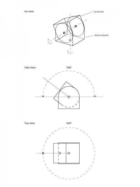

The heliostat design that I've come up with(given the tools at my disposal) involves two metal brackets. The bottom bracket will rotate at a 360º around the vertical axis. The top bracket will be mounted on the bottom bracket and will rotate at a 180º around the horizontal axis. Like this:
The mirror will be mounted on top of the top bracket.

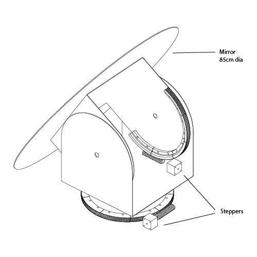

I have been working on a Heliostat mount design in Inventor. Its still a draft. I recalculated the necessary accuracy and realized the best angular resolution would be 0.01º so worm gears would be the most robust and compact gear solution at a 1:180 ratio. Another cool thing about this type of gear is that I can divide the actual gear(not the worm) into sections of 40 degrees(20 teeth) and 3D print each section. Here is the design, hope you guys can give me any feedback before I continue with this project. Would be greatly appreciated!
Frikiflax, I came across this discussion and wondered how the project is coming along? Perhaps I can add some hard lessons learned from participating in a MakerSpace build of an alt-azimuth mount for a telescope. Like you we chose the 40-degree sections of 3D printed gear. The challenge was in the assembly. Try getting all of those "puzzle pieces" lined up in a perfect arc! It is not trivial. You may find that you need a spring on the stepper motor/worm gear assembly in order to compensate for any wobble. If you don't you may end up with slippage and ultimately stripped gears. Just my two cents. Please let me know how it goes!
