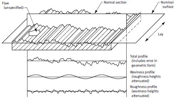

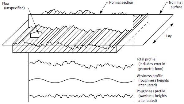

A short course in Surface Texture
Surface Texture Measurement has been around since 1938 when Dr. Ernest J. Abbott invented the Profilometer.
The American Society of Mechanical Engineers (ASME) developed a Measurement Standard that defines “Surface Texture” in the 1940s to govern “the geometric irregularities of surfaces.” B46.1 defines surface roughness, waviness, and lay, as well as parameters for specifying and controlling surface texture. The latest copy of ASME B46.1- 2019 is 130 pages. It is the Bible for Surface Texture.
Note the Normal Section Plane above. It is perpendicular to the Nominal Surface.Gear Inspection Machines use the Skid datum method with a displacement probe. Great for Roughness Parameters and in compliance with the ASME, DIN , ISO Standards. Note the bottom illustration of the Reference surface instrument. It used a very high precision surface internal datum. The linear movement of the stylus is well under 10 millionths of an inch Straightness accuracy.

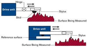

In skidded gages, the sensitive, diamond-tipped stylus is contained within a probe, which has a skid that rests on the workpiece. Skidded gages (upper) measure roughness only. Skidless gages (lower) use an internal precision surface as a reference. This enables skidless gages to be used for measurements of waviness and form, in addition to roughness. Source: Mahr Federal Inc.
