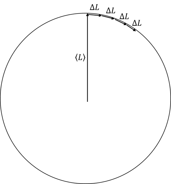

Now, after this point I write the angular momentum with respect to the hanging point and focus on the behavior of the angular momentum.
$$ L=mvd=md^2\dot{\theta}=md^2\omega\theta_0\cos{\omega t} $$
During oscillations angular momentum vector oscillates back and forth in a periodic manner. The vector changes its magnitude and sign as seen from the above equation but stays on a line which is perpendicular to the oscillation plane.
However, in each oscillation this line will be slightly changing its direction because of the torque created by the Coriolis force. Here I take the time average of the magnitude of the angular momentum vector during one oscillation which can be written as
$$ \langle L \rangle = md^2\omega \theta_0\frac{2}{\pi}$$
the last term coming from the time average of the absolute value of the trigonometric function over a period. I did this because I want to “create” a vector representing the plane of oscillation which I can act the slight change caused by the Coriolis torque and observe its rotation.
It is fairly easy to calculate the magnitude of ##\Delta L## by integrating the Coriolis torque over one period. And since we made the assumption 4, the circumference of the circle where the tip of the average angular momentum vector is moving could be approximated by the sum of these small ##\Delta L##’s.
To calculate ##\Delta L## we need to write the torque caused by the Coriolis term and integrate it over one oscillation period.
$$ \tau=2\Omega vmd =\frac{dL}{dt}$$
## \Omega ## being the rotation rate of the coordinate frame. If we substitute ## v ## and integrate over one period we get the following expression for ##\Delta L##:
$$ \Delta L=2\Omega md^2\theta_0\omega \int_{\frac{T}{2}}^{-\frac{T}{2}} \cos{\omega t} \, dt = 4 \Omega md^2\theta_0 $$
Now if we divide the circumference of the above circle by ## \Delta L ## we can get the number of oscillations to complete one rotation of the plane which is:
$$ \frac{md^2\omega\theta_0\frac{2}{\pi}2\pi}{4\Omega m d^2 \theta_0}=\frac{\omega}{\Omega} $$
This expression could also be written in terms of periods and is basically the same result from what we get from the orthodox solutions of the problem.
So my question: is this method justifiable in terms of mathematical rigor since use of time “average” angular momentum vector was purely coming from my physical insight?
No: your result is a tautology: ## n = \dfrac \omega {2\pi} ## and ## N = \dfrac \Omega {2\pi} ## by definition so ## \dfrac n N = \dfrac \omega \Omega ## tells us nothing.
Sorry, I should have made last point more clear: what it tells us that this ratio ##\omega/\Omega## is the number of oscillations required to complete one cycle of the plane rotation. From this since you know the period of SHM as ##2\pi/\omega = T## you can get the period of the plane rotation as ##\omega T/\Omega = 2\pi/\Omega##.
I hope this clarifies the situation. If you prefer to refer to this as tautology, it means the approach is valid right? So rephrase my question: Is there a sort of justification for working with "time average" angular momentum vector as described in my original post.
It was clear the first time round, stating it again doesn't make it any more clear or any less tautological. Can you not see that by defining
you are defining ##\omega/\Omega## as the number of oscillations required to complete one cycle of the plane rotation?
No it doesn't.
pbuk said:
you are defining ω/Ω as the number of oscillations required to complete one cycle of the plane rotation?
No, I am not, I am coming to the conclusion that it is so by dividing the circumference of the circle to ##\Delta L##
I start by the definition of Coriolis force. The ##\Omega## was first introduced there. I am not sure what is your point really? May be you should elaborate your objection please.
You treat L as one-dimensional quantity when you introduce it but then have delta_L orthogonal to it.
Similarly, Omega and v won't be orthogonal to each other in general but then you replace v by scalars.
It looks like a possible approach but these parts should be fixed. See if you can reproduce the usual result for the change of the angle over a day.

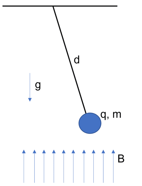

Actually the original olympiad preperation question was an equivalent problem represented below:
Magnetic field from below, charged bob with mass m. There is no Earth rotation so no Coriolis term but an equivalent Lorentz force perpendicular to the plane and proportional to the velocity. The question asks to derive the period of the plane rotation. So it is an equivalent problem. The only assumption stated in this problem was to take ##\frac{d}{g}<<{(\frac{m}{qB})}^2##
So I came up with the above solution instead of the traditional approach and found the oscillation period of the plane as ##\frac{4\pi m}{qB}##. And after that I checked whether it also gives the same result with the ordinary Foucault pendulum and got the correct rotation period as stated above.
So I am pretty sure it gives the correct result. My only concern is its mathematical rigour.
