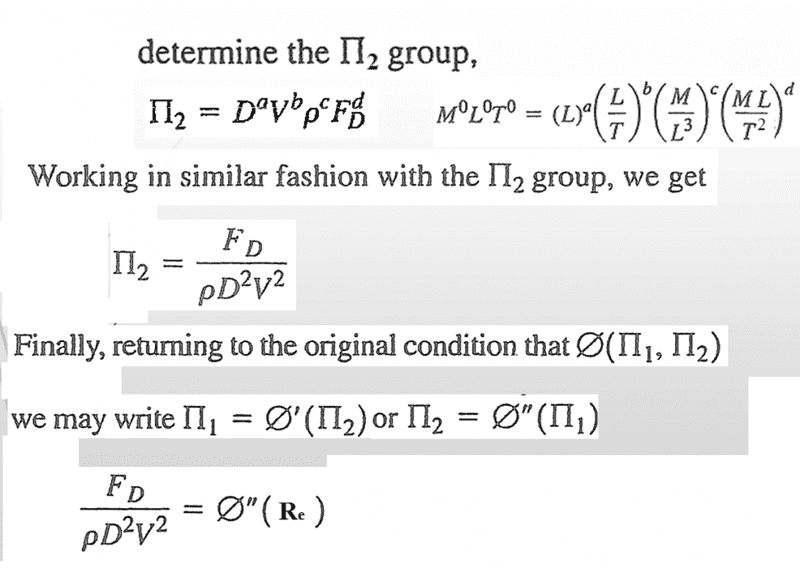

in the third picture , we know that π2 can be written as function of π1 , where π2 is inverse of reynold number , how if i want to change it to π1 = function of π2 , can i write it as (Reynold number ) = F / ρ (D^2)(v^2) ?
p/s : π1 is actually inverse of reynold number
IMO , for π1 = function of π2 , it is also (Reynold number ) = f (F / ρ (D^2)(v^2) ) ... we should write it as reynold number instead of inverse of reynold number , am i right ?

What does upper case phi double prime stand for?
Φ'' (Re) = FD/ρD2V2
Φ'' (Re) = FD/ρD2V2
I think the author means stand for function...

OK. If Φ represents a function then double prime would normally indicate the second derivative of that function.
or , it should be 1/ reynold number = F / ρ (D^2)(v^2) ?
which one is correct ?
1/Re = F/ρD2V2
where F = viscous forces
David Lewis said:
1/Re = F/ρD2V2
is it wrong to write it as (Reynold number ) = F / ρ (D^2)(v^2) ?
is there a need to change 1/ Re to Re for π1 in this case
P/s : π1 = function of ( π2 , π3 )
The Reynolds number is dimensionless, so the numerator and denominator will have the same fundamental dimensions (M, L, T).
In aeronautics, the denominator (viscous forces) is smaller than the numerator (inertial forces) -- possibly 5 or 6 orders of magnitude smaller -- which makes Re a large number.
Likes foo9008
So, no matter pi 1 is Reynold number = ( pi 2 , pi3) or pi 1 is 1/ reynold number d= ( pi2, pi3) are correct??
2 = FD/ρD2V2
