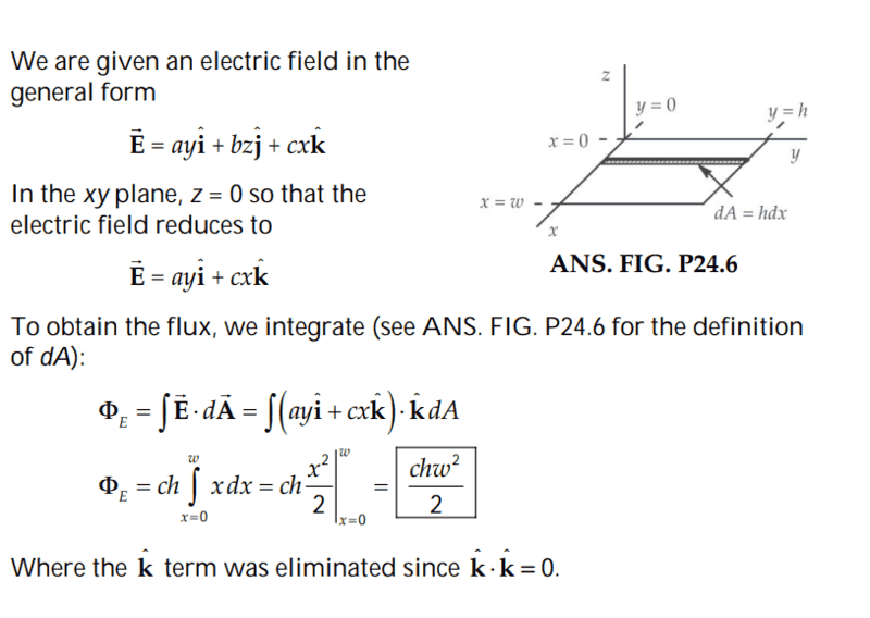

The solution is,
However, why can the differential area not be:
I tried integrating and got,

First of all ##\hat k\cdot \hat k=1##, not zero. I think they meant to say ##\hat i\cdot \hat k=0## which is correct. The differential area is ##dA=dx~dy.## It cannot be ##dA=wdh## because ##h## is constant. Have you been taught double integration?

Since x is a variable across the integration area, it cannot appear in the answer.
A general fact in Cartesian coordinates is dA=dx.dy, and to integrate over an area you have to integrate wrt each. You can do the integration in either order.
In the present case, the function being integrated is a function of x only. That makes the integration wrt y trivial: ##\int_{x=0}^{w}\int_{y=0}^h f(x).dy.dx=\int_{x=0}^{w}h f(x).dx##.
You method fails because ##\int_{x=0}^{w} f(x).dx\neq wf(x)##. Indeed, that would be a nonsense because ##\int_{x=0}^{w} f(x).dx## is not a function of a variable x.

Only the ##z## component of the field (which is dependent on ##x##) will produce flux through said sheet.
If you are not familiar with double integration let’s find a work around
Part 2
Can you find the “flux” through the infinitesimally small sliver that straddles the x-axis (I.e. y = 0)?
Part 3
Now look at the other slivers that comprises the area (other ##y = constant## slivers). Given the expression for the field do you expect these flux values to change for subsequent slivers after the sliver flux found in part 2?
If not how would you take your answer from part 2 and apply it to the whole plane in question?

You can take advantage of the fact that the component of the electric field along z (the only one that matters) depends only on x (and not y). So you can divide the area into strips along the y-axis, of area dA=h dx. They all have the same value of the field as they have the same value of x. The integral should be on the variable x as the field depends on x. This type of "shortcut" is used a lot in introductory courses so you don't need to know multivariable calculus to solve the problem. Even though it results from the double integral, as shown by kuruman.
