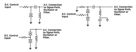

Can you change the tuning instead by varying the capacitance? A Varicap comes to mind whereby the capacitance can be selected by altering the DC bias across it. I don't know off hand if there are varicaps with a suitable range for your application, but I do know that they are used in RF tuners.

Well, varicaps are capacitors. They're variable by applied DC reverse bias. Wikipedia shows a few example circuits.
https://en.wikipedia.org/wiki/Varicap

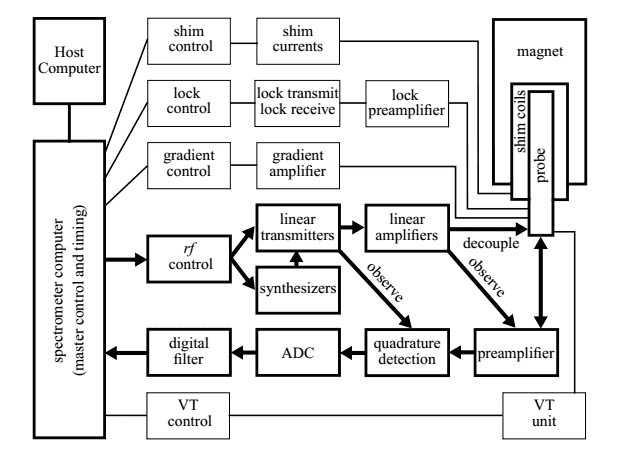

The AMP is a wide-band RF amplifier operating in linear class AB (N-MOSFET) that provides hundreds peak RF power over a frequency range 6-500 MHz for any combination of pulse width and duty cycle up to 100ms and 10%.

I want to thank you for giving me the opportunity to clarify some aspects:
Baluncore said:
You are confusing up and down in the vertical axis with horizontal side to side movement.
Never talked about horizontal movements. I talked ONLY about movement along the magnet axis, which is VERTICAL.
Baluncore said:
1. What do you gain by having irrational coordinates in multiple reference frames?
Baluncore said:
2. Is the “coil/resonator” the probe?
The coil (or resonator) is a part of the probe, it is inside the probe. By probe we mean the device in its entirety that allows one to make a measurement when connected to a properly hardware.
Baluncore said:
3. Is that probe a coupling loop antenna?
A probe is a probe. Are you talking about the coil?
Baluncore said:
4. Is the sample held in and moved with the probe?
Yes, the sample is inside the coil and it moves together with the coil.
Baluncore said:
5. Would your spectrum of CCLR tuned circuits only be part of the receive circuit, or will the transmit pulse also use that path? Even with isolation switches, the presence of tuned circuits in the signal path will ring and produce artefacts that I expect will hide or distort the signal from your sample.
The probe is involved in both TX/RX process. Power from linear transmitters/amplifiers is delivered to the probe for "exciting" the sample (TX), thus the small NMR signal is detected by the same probe (RX), then preamplfied, detected, digitized, filtered and elaborated by PC.

But you do not need sliding contacts.
I might digitise probe position and then use that to set the centre frequency of my receiver, based on the previously mapped field strength. I would find it too difficult to calibrate a whole spectrum of tuned circuits, then to re-adjust their physical position as the magnetic field drifted.
But it is not a question of calibrating the whole spectrum of tunable frequencies; rather, it is a matter of creating n discrete tuning circuits suitable for frequencies predefined by the field/position: it is much simpler!
Cheers

That is going to be... CHALLENGING. I'm sure there are a few RF experts around here with better ideas, but here is a semi-informed first pass.
Overall it looks like separate transmit and receive coils are a good bet. I'll be concentrating on the receive part.
At 800MHz a coil of 22nH and a capacitor of 1.8pF will resonant. To give an idea of size, a 1 turn coil, 3/8in. dia., of 40AWG 30AWG (0.010 dia) wire yields 22nH. Keeping stray capacitance below 1.8pF requires rather small circuit construction. That would indicate putting a pre-amp directly adjacent to the coil. A Mini-Circuits LHA-13LN+ is a possibility for a pre-amp https://www.minicircuits.com/WebStore/dashboard.html?model=LHA-13LN+.
Since you are talking tens of watts, the pre-amp will need input protection. A pair of PIN RF-Microwave diodes in anti-parallel across the input may suffice. Here is a link to one source of PIN diodes. https://www.microsemi.com/document-...icrowave-diode-and-transistor-product-catalog
For higher power and isolation, another design for diode switching is a bridge circuit. As used in a fullwave bridge rectifier circuit, but the RF comes in and exits where the power transformer would be, and the control voltage is applied at what would normally be the output. When the control voltage biases the diodes ON there is an RF path thru the bridge. At higher powers, the control voltage polarity can be reversed to ensure the diodes stay OFF.
The pre-amp would be wideband with the receive tuned circuits at the RF receiver, away from the head. Tuned circuit selection could be done using a diode switching approach. For examples see:
https://www.radio-electronics.com/info/circuits/diode-rf-attenuator/pin-diode-switch.php
https://www.electroschematics.com/3002/pin-diode-rf-switch/
The Transmit is "Left as an exercise for others." :wink:
