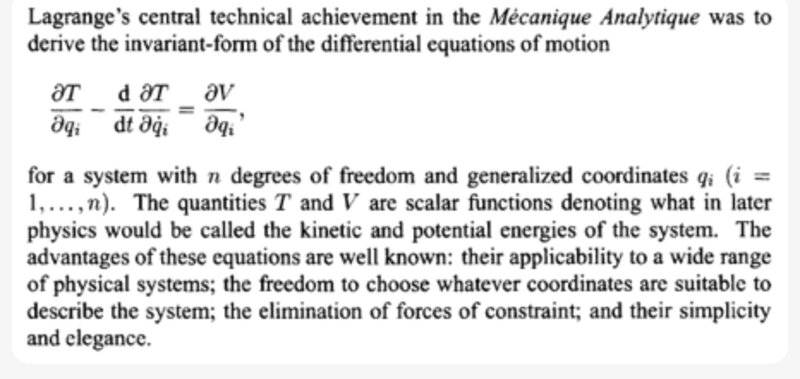

He didn’t.
I believe Hamilton did later.

It does. He found a relation between T and V. He wasn‘t looking at f(T,V).
