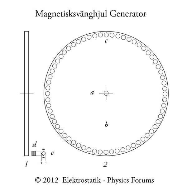

Sixty N55 Neodymium magnets with a mass of 159 g each will be mounted in force fit holes around the perimeter of a polycarbonate flywheel, parallel to the rotation axis, the 28 kg flywheel has 35% of it's mass at the perimeter
and stores kinetic energy with a moment of inertia of around 16 kg/m², an angular velocity of 125.6 rad/s ( 20 rev/s),
so an angular momentum of 2009 N·m·s
at this rotation speed, the 60 magnets produce an alternating frequency of 1200 Hz
120 inductors are to be fixed on 2 stationary ring mounts, 60 on each side of the flywheel
aligned with the 60 flywheel magnets, so that the magnet poles pass directly over the inductor coils coaxially (orientated face to face)
the inductors on the opposite side are mounted 90° out of phase for full DC rectification,
with each inductor having it's own bridge rectifier and each fed into it's own voltage regulator.
So this is not like any existing generator
make sure your magnetic circuit is a closed loop - only air part should be the airgap you need for mechanical clearance.
Kirchoff's Law for Magnetic Flux, if you will allow me that misuse , says the flux must get back to opposite end of your magnet. You want it to get there through iron not air.I suppose that's what your ring mounts do?
Sorry for the endless questions, just it's so hard to paint or imagine a mental picture from words only...
"Science is language well arranged" - Lavoisierold jim
If you mean the air gap between the poles of the flywheel driver magnets and the tops of the inductor cores,
the mechanical clearance gap would be no more than 1 mm.

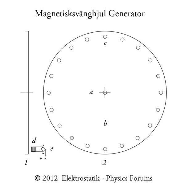

you can get a good mental picture of the design if you visualise an 810 mm Ø x 30 mm disk flywheel
rotating on an x axis, with sixty 30 mm holes drilled around the perimeter, parallel to the rotation axis,
10 mm from the outer edge, with a 40 mm centre-centre spacing, forming a ring of 60 magnets,
Each neodymium magnet is 30 mm Ø x 30 mm and force fit into the 60 holes around the outer perimeter of the flywheel,
with both poles sitting flush with the left and right side surfaces of the flywheel,
the polarity of each adjacent magnet is reversed : N - S - N - S..
inducing an alternating current in the inductors as the flywheel rotates at 20 revolutions per second,
with 60 alternating poles per revolution, producing a 1200 Hz alternating current.
The flywheel magnets hover past the stationary inductors in a parallel plane,
the inductors form 2 inductor arrays, one on each side of the flywheel, one array shifted 90° out of phase
relative to the other, and each mounted on two 810 mm Ø support rings on either side of the flywheel.
Both the flywheel and inductor support rings are non-conductive polycarbonate
and have no influence on the magnetic field.

First off all i can say that (if I have understod the design correct) you wouldn't get 1.5 T through your armature coil. Look at the B(H) curve of your magnet. This because your flux path has a very high reluctance ( mostly material with permeability of 1). Thus the leakage flux in the machine would be large.
As mentioned before, like a transformer core, the complete flux path should be closed ( except the air gap between rotor and stator) by a material with high permeability. Related to your design, the inductor support rings should be made of soft iron.
Or have I miss understood the design? A simple drawing (from the top) would be helpful.

Here is a diagramme of the machine :
1. EDGE VIEW
2. SIDE VIEW
a. axis - high precision bearing
b. polycarbonate flywheel
c. neodymium N55 permanent magnet 30 mm Ø x 30 mm
d. electromagnetic transducer coil
e. bridge rectifier
This is a simplified example of the design - showing only 1 transducer coil
in the actual working model - there are 120 transducer coils operating independently
60 on either side of the flywheel, Group A and Group B - 90° out of phase with Group A.
The target output for each transducer coil is 18 - 30 V with a peak current of 10 A

Jim, do you think a 10 mm spacing between magnets will produce an unbroken sine wave?
I will not be able to test the output with an oscilloscope until both the flywheel and 1 transducer coil are completed,
and once I build the flywheel I've already invested quite a bit of time and money in materials,
so I need to get it right the first time.
Knowing how much trouble manufacturers take to produce a sine wave flux i will be surprised if you get a precise one with just magnets.
Here's a calculator that figures flux a point in space near a magnet of given shape
http://www.kjmagnetics.com/fieldcalculator.asp
i used it to figure a couple points 15mm above a 30mm X 30 mm N42 cylinder; it didnt offer me N55.
Y component on center 1597 gauss
halfway between center and edge 1417
at edge 879
5mm beyond edge 550
10mm past edge 290
40mm past edge it's 6.3, essentially zero
so the flux is highest in center like a cosine function
and if we take 40cm as distance from peak to zero
879/1597 is arccos of 56.6° but 15/40 of 90° is 33.6°
similarly 550/1597 is arccos of 69.8 but 20/40 of 90° is 45°
so flux from a single magnet only resembles a sinusoid at that distance, it's too peaky.. as one would expect.

Aha, so for N42 the centre to centre spacing between magnets would need to be 110 mm for a zero to peak sinusoid,
and for N55 an even wider spacing.
For making DC a flat-topped wave is better anyhow, because the valleys between peaks are narrower easing job of filter capacitor.
of course, a square wave would be ideal, since a square wave would rectify to flat DC
without the need for a second wave 90° out of phase. I was planning a coil with a square cross section, which has a 3:1 aspect when the core is also square,
and this gives a low and fat inductor profile.
I also considered using a Tesla spiral coil http://www.theoldscientist.co.uk/Bifilar_Tesla_Coil.html which has the most extreme voltage drop
between turns, but maybe this is a bit over the top.Yes, the poles are alternated N - S

I've updated the design to account for adjacent magnetic field geometry at 110 mm centre to centre spacing.
To keep the flywheel size within 1 m Ø I've reduced the magnet count to 20
so at 20 rev/s the frequency is now down to the aviation standard of 400 Hz
This not only improves the sinusoidal output and transducer efficiency but also reduces the cost of N55s to 33%

I based the design changes on your N42 zero to peak gauss curve - 110 mm centre to centre.
I just assumed it would be more efficient to allow a full zero to peak sinusoid by spacing 40 mm from the edge.
at edge 879
5mm beyond edge 550
10mm past edge 290
But then.. what seems intuitive to me doesn't necessarily make it right.
Traditional dynamos are DC generators that operate on the reverse DC motor principle using a commutator,
so would these same density rules apply to an open alternating principle?
  • #35
i was trying to demonstrate that the sine function results from design of the flux field
i don't see connection between its shape and "eficiency". Sine wave is aesthetic though.
best 'efficiency' will be achieved by maximixing the fraction of field flux from your magnets that links (goes through) your windings.
That's why your iron cores in middle of your coils were a good feature IMO.
You do understand that the magnetic path for each magnet is from N to S pole , and you want as much of that path as possible to be through the coil.
Iron core can encourage the majority of flux to take that route. An iron return path will help too.
EDIT :: and yes, a synchronous machine can motor or generate.
