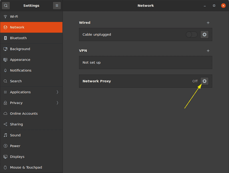

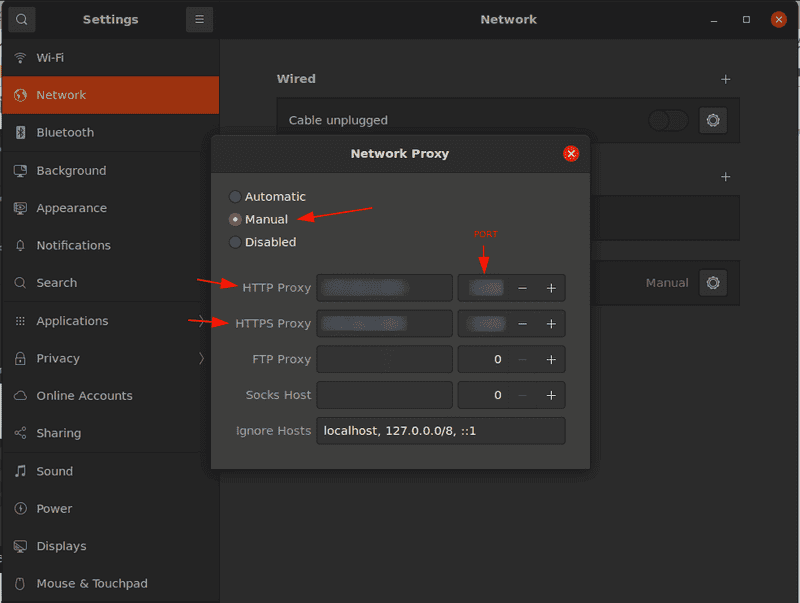

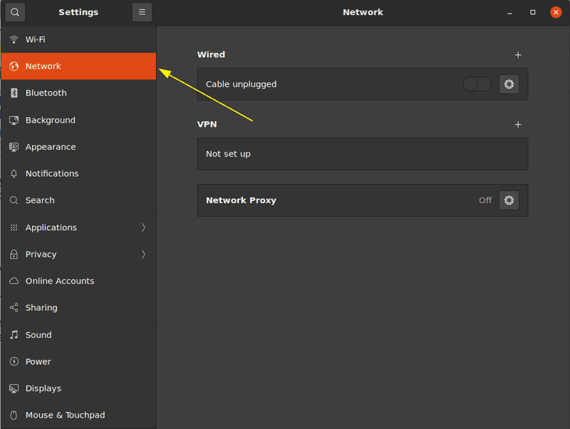

I am not sure how to set proxy using environment variable, but in the past, I have followed the steps below, and it worked fine for Chrome.
Step 1: Go to Settings.
Step 2: Go to Network on the LHS panel:
Step 3: Click on the gear button next to Network Proxy:
Step 4: Choose "Manual" and set up the proxy:
Step 5: You can just close the windows after setting up. Changes should take place immediately.
