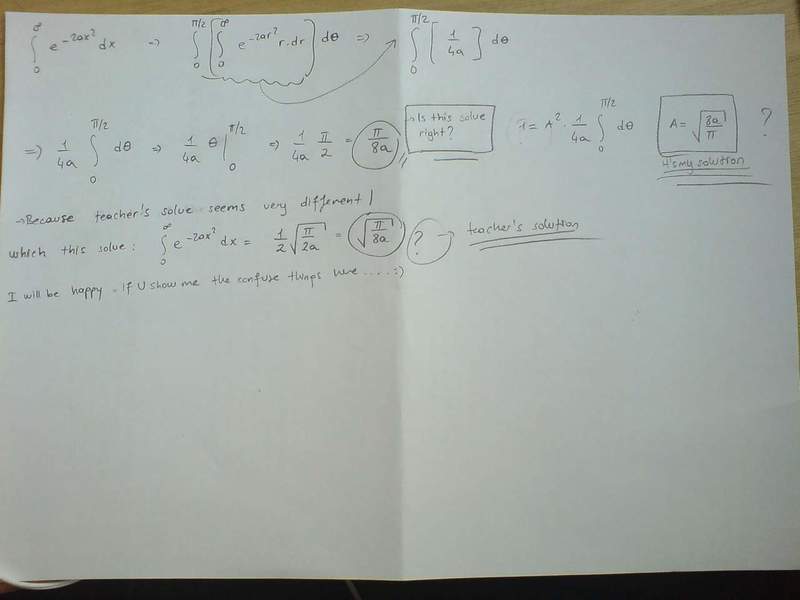

Please help for this probability function !

yes, as you said, I have tried to solve this problem and I wrote in the paper that I've found value... I've checked again and again,I found the same value like in the paper.. ??:(
Well, I'll give you a quick answer, and a slow question.
In your notes you write: 1 = A^2 \frac 1 {4a} \int_0^{\pi/2}d\theta
This is wrong. It should be: A^2 = \frac 1 {4a} \int_0^{\pi/2}d\theta
Applying this should give you the same answer as your teacher.
The slow question is: what happened in the first step?
You move here from a single integral over x to a double integral over r and theta.
Do you know what the line of reasoning is here?
Note that this is the most important step in the reasoning.
actually,I d be appreciate that, If you explain you asked question. What did you want to ask me about the line of reasoning?
I'll give you the step.
It is:
<br /> A^2 = \int_0^{\infty} e^{-2ax^2} dx \cdot \int_0^{\infty} e^{-2ax^2} dx <br /> = \int_0^{\infty} e^{-2ax^2} dx \cdot \int_0^{\infty} e^{-2ay^2} dy<br /> = \int_0^{\infty} \int_0^{\infty} e^{-2ax^2} e^{-2ay^2} dxdy<br /> = \int_0^{\infty} \int_0^{\infty} e^{-2a(x^2+y^2)} dxdy<br />
This is a surface integral in cartesian coordinates over the first quadrant.
Now we shift to polar coordinates over the first quadrant, which means that r goes from 0 to infinity and theta goes from 0 to pi/2.
Also where in cartesian coordinates we have dxdy as an infinitesimal surface element, in polar coordinates we have r.dtheta.dr.
In other words:
<br /> A^2 = \int_0^{\infty} \int_0^{\infty} e^{-2a(x^2+y^2)} dxdy<br /> = \int_0^{\frac {\pi} 2} \int_0^{\infty} e^{-2a(r^2)} r dr d\theta<br />
Does this make sense to you?

It's possible of course, but it seems unlikely to me.
Note that it's just a "trick" to be able to calculate the original integral from 0 to infinity.
Furthermore, in probability theory we're usually interested in the range from -infinity to +infinity.
