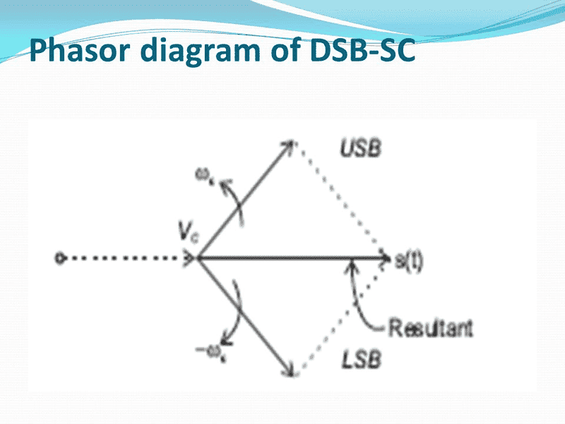

Your idea of "leakage" makes assumptions about the method whereby AM is achieved. You can use the familiar phasor notation to describe the process:
The diagram shows a Carrier phasor (Vc) and two added sidebands (ω and -ω). The result (in this case for 100% mod) varies in amplitude from 2Vc to zero. The mean carrier power is the same for all mod indices. Sideband power comes from the modulator power supply. `So the peak radiated power will be four times carrier power (i.e. twice carrier amplitude.
For the modulation to be linear (i.e. producing detected modulation signal that's proportional to the input) I don't think you can 'lose' any of the carrier power into the sideband components. The AM has to add mod power to achieve proper AM - or, you could say, Zero DC information?

Side bands can be understood from high school trig identities:
When you modulate, you are using a multiplication operation implemented in analog circuitry. All "mixers" are essentially multipliers. That's why the symbol for a mixer is a circle with an inscribed "X".
So say this involves a carrier and modulation cosine wave:
fc(t) = cos(2π fc t)
fm(t) = cos(2π fm t)
Now multiple these:
fc(t) x fm(t) = cos(2π fc t) x cos(2π fm t)
So there's a trig identity for the right side:
cos(2π fc t) x cos(2π fm t) = 1/2 x ( cos(2π (fc+fm) t) + cos(2π (fc-fm) t)
https://4.bp.blogspot.com/-OozzXCo4U94/VmgwnsJT5fI/AAAAAAAABEo/8gmyYkNre5M/s1600/1.png
Now notice this is equivalent to modulation signal below AND above the carrier offset by the modulation frequency. These are the lower and upper sidebands. Because the modulation is a LINEAR combination of individual frequencies, this causes the replica of the entire modulation spectrum to appear as the upper sideband and a mirrored version to appeared as the lower sideband.
So sidebands are a natural result of multiplying the carrier and modulation. This is a universal feature of modulation when multiplication is part of the process: e.g. digital IQ modulation as well as AM, DSB, etc. With AM you also have the equivalent of this plus an inserted carrier that is 2x the side of an individual sideband. The above is precisely DSB (double sideband) modulation. CW happens to create very small sidebands as the carrier is pulsed on and off, multiplicatively.
