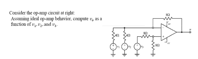

Am I doing this ideal op-amp problem correctly?
  • Thread starter pinterest
  • Tags
    Op-amp
In summary, the conversation discusses solving a circuit problem using voltage division and the node-voltage method. The resulting equation for V0 is 5/2V3-2V1-2V2, but there is some confusion about the value of V3 and how it affects the output. The conversation suggests taking one input at a time and using superposition to find the corresponding output, with the other voltage sources being set to zero volts.
pinterest
[tex]Vp=Vn[/tex]
[tex]Ip=In=0[/tex]
By voltage division:
[tex]Vp = 8/(8+8) V3[/tex]
[tex]Vp = 1/2V3[/tex]
[tex]Vn = 1/2V3[/tex]
By node-voltage method at the inverting input terminal:
[tex](Vn-V1)/4 + (Vn-V2)/4 + (Vn- V0)/8 = 0[/tex]
Multiply equation by 8
[tex]2(Vn-V1) + 2(Vn-V2) + Vn-V0 = 0[/tex]
[tex]V0 = Vn+2Vn-2V1+2Vn-2V2[/tex]
[tex]V0 = 5Vn-2V1-2V2[/tex]
Substitute in 1/2V3 for Vn
[tex]V0 = 5/2V3-2V1-2V2[/tex]
Is this the correct answer? I'm pretty sure about the V1 and V2 part, because it matches the summing amplifier circuit equation of -(Rf/R1*V1+Rf/R2*V2). However, for V3, I don't see how its resistor composition would yield an answer of 5/2. Could someone clarify?
Thanks
One easy way to work problems with multiple inputs is to take one input at a time, get the corresponding output, then add all three outputs. So for your worrisome V3 input the output is
Vo3 = V+(1 + Rf/Ri) = 0.5V3(1 + Rf/Ri) = 0.5V3(1 + 8/2) = 2.5V3
Also,
Vo1 = -8/4 v1
Vo2 = -8/4 v2
Then by superposition,
Vo = Vo1 + Vo2 + Vo3.
Note that when you do that the other voltage sources are set to zero volts (grounded), not left 'floating'.
