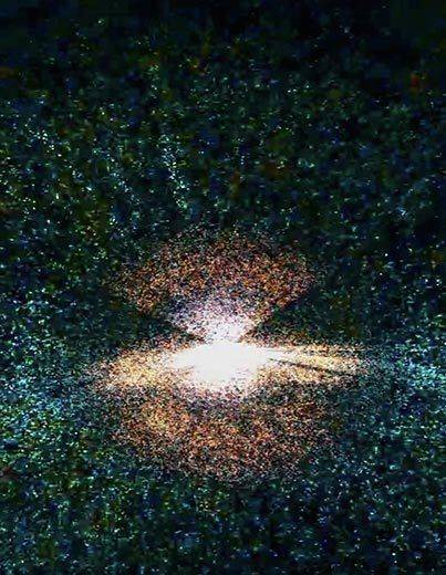

I would like to add another question which is - remotely - connected to the topic of this thread. As far as I understood, isotropy not only dictates a homogenous space-time-continuum, but as I understood also a relatively homogenous distribution of matter (despite this homogeneity is not absolute, so you have filaments, voids etc.).
My question refers to this picture that I added - the galaxy map of the Sloan Digital Sky Survey.
1) The description says that in the center of it is Earth and our galaxy - I suppose, however, this is only due to the perspective, i.e. the fact that Earth is our "basis of observation" - expressed differently: it is an "imaginary or subjective" center.
2) Every dot or point on the map represents a large structure like a galaxy. Why does it appear that in the center region (i.e. where our galaxy is located) the concentration is strongest - as if there were a much larger mass concentration compared to the peripheral region? Is this also an observation bias?
Greetings Andreas
The SSDS (like all telescopes) can only detect galaxies brighter than a certain magnitude, the http://en.wikipedia.org/wiki/Sloan_Digital_Sky_Survey" than the co-moving distance (which gives a redshift of about 0.40). I do not know which notion of distance is used in the picture, but this corresponds to a light travel time of ~4.3 billion years (so less than a third of the largest possible). I do not know enough about the SSDS or the picture to determine if this is the source of the overdensity/underdensity, but it seems plausible.
