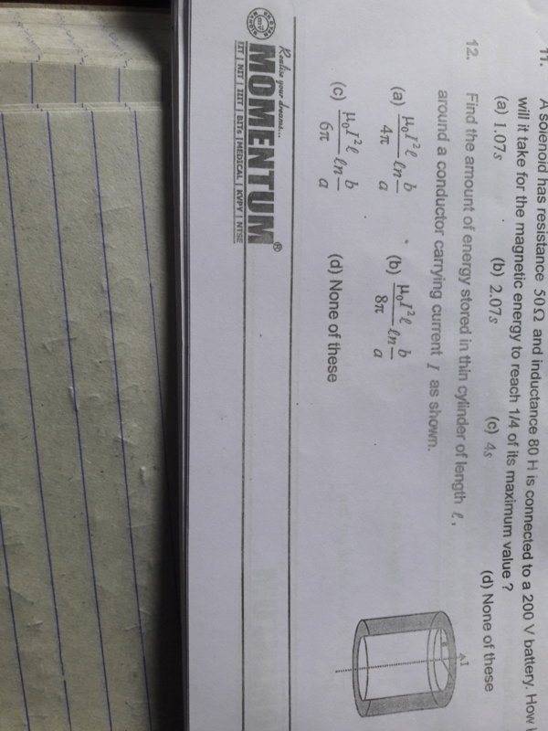

Find the amount of energy stored in thin cylinder of length l,around a conductor carrying current I as shown.
The figure is in Attempt at a solution.
E=0.5LI^2
Ampere's Circuital Law
Inductance=Flux/Current
I first calculated Magnetic field at a distance x using Ampere's law.Then i took an element and wrote its inductance using L=Flux/Current.
Then i integrated from a to b.
But i arrived at nothing.
Help.
What is the energy density stored in a magnetic field of a given strength?
It is Energy per unit volume,so should i first find energy for a part by energy density and integrate it?
You should find a relation that links energy density of a magnetic field (what you need) to the field strength (what you calculated).
yeah i think it is energy density=B2##/##2u0
Thanks i got the answer.Earlier i thought that this result was valid for only solenoid.But it is for all cases is it?
The formula for the energy density is valid for all cases (in vacuum, technically, but it is a good approximation in air). How the field strength varies in space depends on the geometry of the cables.
