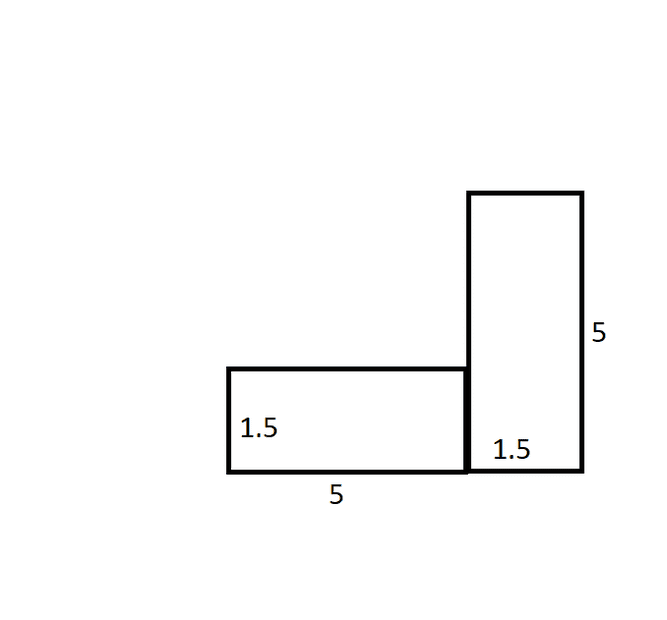

A 2kg brick of dimension 5m*2.5m*1.5m is lying on the largest base. It is now made to stand with length vertical, then amount of work done is (g=10)
W=F.d
W=-mgd=2*10*1.5=30J. I don’t think this is right.

Make two drawings
BvU said:
Make two drawings

This (surprisingly large) brick measures 5m x 2.5m x 1.5m. And its mass is only 2kg.
That means its density is far less than the density of air. So the brick will just float away. They don’t make bricks like they used to.

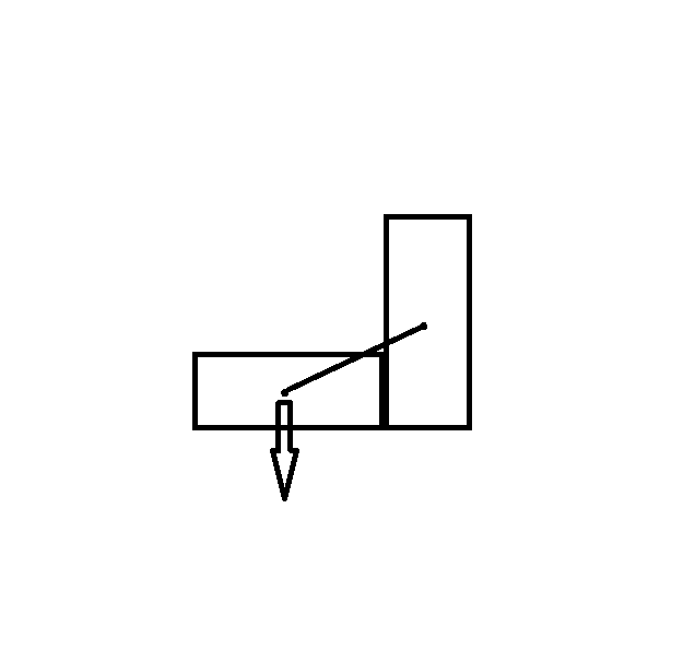

Good. Now: how far do you have to lift the left one, in order to get it on the same average height as the right one?
Likes vcsharp2003

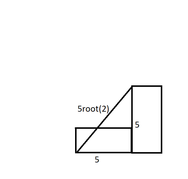

I guess ##\sqrt{5^2+5^2}=5\sqrt2##
This is PF, not a guessing game. How did you come to this strange result?
Likes Hall
Draw the 'lifted' case according to your result...
Like this:oldbiggrin:. I took a corner and calculated how far that corner travels but for different corners its different.

But if you lift the whole block by that much, it is well above the other!
That's why I said you got to take the position of the COM , not that of a corner, and find not exactly how much the COM travels but the difference in height.

Lifting means moving straight upwards...
W=-mg(2.5-0.75)=-2*10*1.75=-35 J
