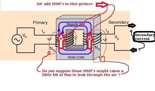

Congratulations - your question halfway answered itself. Just needs a little thought now. Apply what you already know..
A picture is often worth a thousand words.
I snipped this from Hyperphysics wonderful transformer page , hopefully they won't mind because snip and paste doesn't cause them extra server traffic.
Annotations in red are mine.
I think you can answer both your questions now.
At zero load current the EDIT primary MMF is only whatever it takes to magnetize the core, secondary MMF is of course zero..
As you allow load current, MMF's go up from there
Remember what inductance is - flux per amp-turn/

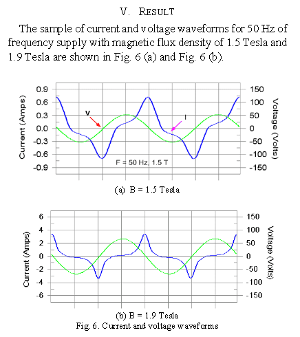

gorlyu said:
Would you not then have different amount of leakage flux for different flux densities in the core (since the permeability varies with flux density)? I.e. you would observe some kind of non-linearity in your leakage inductance.
Indeed . You can easily show this with an oscilloscope and a coil of wire.
Hold the coil right next to the laminations of an energized transformer. You will see not a clean sine wave but a distorted one with exaggerated peaks, really rich in third harmonics. . As the flux walks up the B-H curve every cycle that nonlinear reluctance squeezes more flux through the air. It shows up in magnetizing current waveform too...
see http://www.jocet.org/papers/69-A30009.pdf
The blue current wave makes a sine wave flux in iron but not in air. That's why leakage flux looks so peaky.
Try it - sure made the light come on in my brain!(alleged though it is) It's really pronounced on a ferroresonant transformer...
Stay curious, and use everyday experience to figure things out. Every little mystery is an experiment waiting to happen.

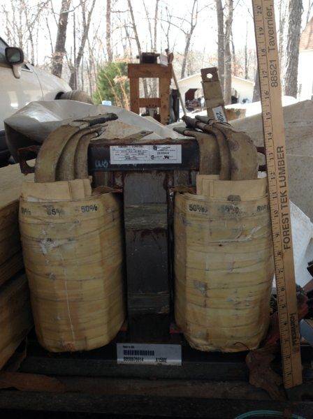

jim hardy said:
I have one that cost me $90 at 30 cents per pound.
And you had these guys unload it for you?
Photograph?
I'll snap one and post when Fair Anne's Ipad finishes charging...

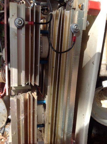

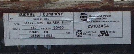

it was part of an autotransformer based reduced voltage starter .
Was brand new but the guys sort of tossed it around with their big magnet crane...
detail of nameplate

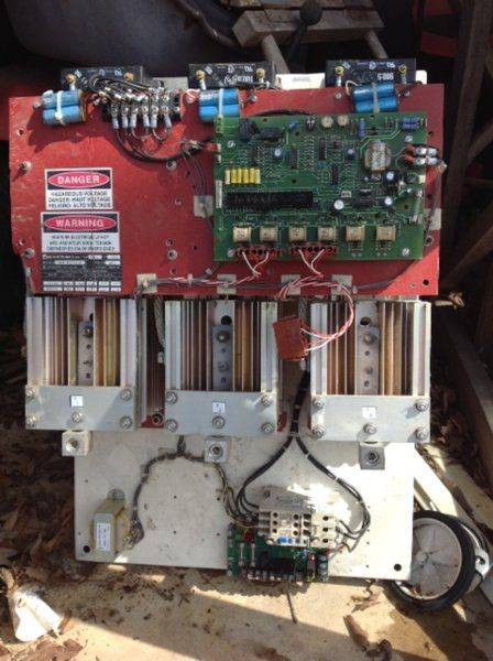

while i was there... how could a fellow pass up an electronic one too?
with these bodacious rectifiers
i think there's enough here to synthesize three phase variable frequency...
sigh. i can't keep up with @dlgoff for creativity though.

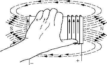

Something I just learned, thanks to you, from investigating magnetomotive force(MMF); the Left-hand Rule to Find North Pole of an Electromagnet:
Likes jim hardy
