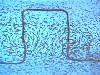

Place iron filings around a wire and observe the pattern.
Then figure out what math describes it.

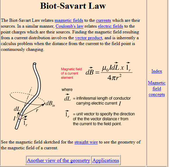

http://hyperphysics.phy-astr.gsu.edu/hbase/magnetic/biosav.html
Scientific method:
Observe something.
Then figure out what math explains the observations.
Then see if the math ever fails, and when it does adjust it.
