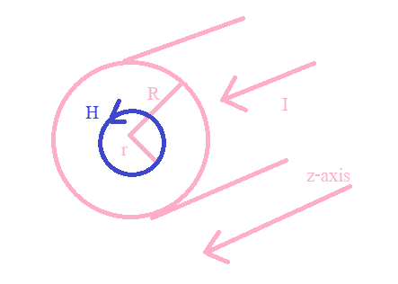

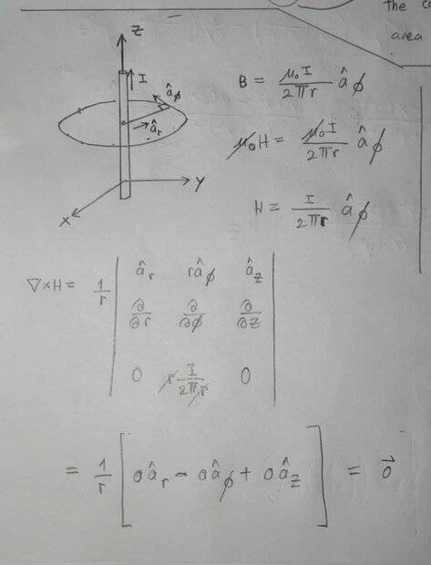

Please refer to the picture below. I would like to understand the equation Curl(H) = J, where H is the magnetic field intensity and J is the current density. So, I inspect a simple problem.
There is a wire carrying current I in the z-axis direction. a_r, a_phi, and a_z are the unit vectors in the directions of the radius, the tangential line, and z-axis, respectively.
So, from H = I/(2*pi*r)a_phi. I take the curl of this vector (in cylindrical coordinate) and got 0. How does this relate to the current density?
Best
BlackMelon
The field you've written down is the field outside a current carrying wire. What would you expect for the current density outside a wire?
Oh well it's zero. That was the silly of me LOL. Thank you very much.
By the way, I have analyzed the inside of the wire H = I*r/(2*pi*R^2) a_phi.
where r is the radius from the center of the wire to the point of interest. R is the radius of the wire. And got the correct answer:
J = curl (H) = I/(pi*R^2) a_z
