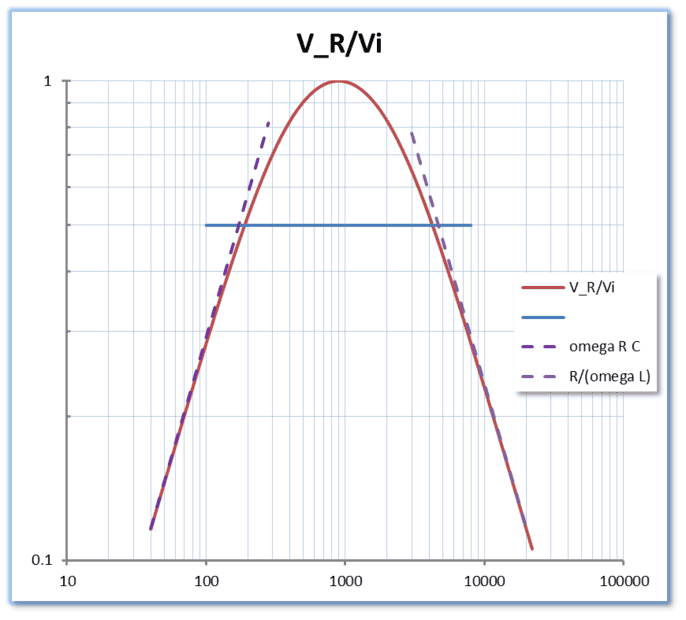

The 'gain' expression for this circuit $$A_V = {R\over \sqrt{R^2 +\left (\omega L-{1\over \omega C}\right)^2}}$$simplifies to $$\begin{align*}
A_V &= \omega RC \quad &\text{for}\quad \omega << \omega_0 \\
A_V &= R/(\omega L) \quad &\text{for}\quad \omega >> \omega_0
\end{align*} $$as a plot of ##A## vs frequency shows (log-log plot so that approximations show up as straight lines; also: ##\omega_0 = \sqrt{\omega_2\omega_1} \Rightarrow f_0= 894 Hz##).
(Blue horizontal line for ##A_V = 0.5##)
In the exercise circuit, damping is considerable (##\omega_2-\omega_1 > \omega_0## -- I get ##\alpha = 7332\ (1167 \ {\sf\text{Hz}}), \ \zeta = 1.3 ) ## for the points where ##A={1\over 2}\sqrt 2##.
