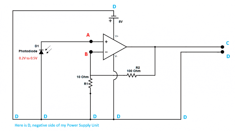

Dear electrical engineers,
Here a question from a serious electronics n00b =D.
I tried to build a system as shown in the image. I have a photodiode which gives me a clock signal in the range of 200 to 500mV. Frequency will be in the range of 100 to 1000 Hz.
I would like to amplify this signal in order to have a voltage between C and D in the range of 2 to 5V, hence my goal gain should be around 10.

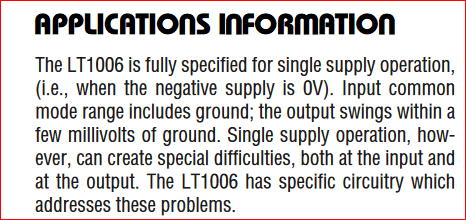

I have an LT1006 amplifier, which should be fine for this purpose (Documentation HERE). I'm trying to use it as a Non-Inverting OpAmp.
Useless to say that my system does not work. Somehow I get a constant output of about 2V regardless of the diode status.
There must be some gross mistake somewhere, but I have no idea. Could someone tell me what did I do wrong?
Thanks in advance,
Mazzo
Normally, with a constant voltage output, that means you're railing. Is your input voltage +/- 2V by any chance?
Try removing the gain and see what happens. Check for shorts, make sure your feedback loop is connected properly.
Op amps can never output a higher voltage than their source. If your gain function ##g## times the output voltage ##V_{out}## is higher than your source voltage (+/- 5V in the diagram), you will get your source voltage as your output.
Also, how are you reading it? I'm assuming an o-scope? Perhaps it's just ticking too fast? All diodes are not made equal, meaning that if you're trying to get it to break down, you need very close to what's called the "breakdown voltage", but you want it to breakdown only when photons hit it. So you want it to be below.
Another possibility, is you photodiode lighting up? You might have it in backwards, which just allows current to flow through it, as opposed to it being reverse biased.
I see you have no bias resistor from the diode to Ground. I would imagine that could define the Volts on the Diode better than relying on the OP Amp input resistor. Try a few tens of kOhm. Have you looked at the diode volts with a DVM? Could be interesting.
Also, why choose such low resistor values in your feedback loop? I'd be inclined to use at least 10 times those values.
Hello guys,
thanks both of you for your answers! Let's reply with order:
@BiGyElLoWhAt
- I'm using an adjustable power supply unit, set to 5V.
- I'm testing the photodiode just by intermittently illuminating it with a flashlight. By hand. The diode alone, plugged straight into an o-scope (or a multimeter) works fine. Ambient light gives about 200mV and direct flashlight gives 500mV. I would say it works.
- About the diode being backward. This is interesting :biggrin:. Diode receives light and gives me a voltage drop across its plugs: I plugged the hi-voltage side to the + side of my OpAmp. Negative side goes to D (that's my negative PSU plug). Is that wrong?
- Question: what do you mean by +-5V? Why would you say there's a negative voltage? Can't I just consider that my negative PSU connector is zero volts and the positive one is at +5V?
@sophiecentaur
- Grounding is in fact the muddiest point of the story for me. Gonna show you my infinite ignorance: why would I need to ground anything?
- I checked my diode health status with a multimeter. It works. Ambient light gives about 200mV and direct flashlight gives 500mV.
- About resistors, I have actually just set their ratio (that's 10) and I've randomly chosen their resistance magnitudes. How does that affects the system? By the way I'll test higher resistances as soon as I'm back in the lab.

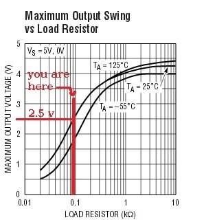

here's why you can't get more than about 2 volts
from datasheet you posted
try 100X larger resistors.
old jim
EDIT i see Sophie caught it too
that should work

As Sophie pointed out
your circuit allows no current through the photodiode
so the first photon to strike it drives it to full voltage
and its capacitance holds it there
That's an exagggeration of course but only a mild one
a resistor across diode gives the charges someplace to go
try a megohm ?
The opamp has a few nanoamps of input current
see parameter "Input Bias Currrent", 9 to 15 na,
and your circuit must provide a path for that trickle . You want it not to flow through your photodiode.

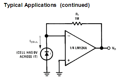

AHA because it looks like you are driving your single supply opamp's input negative in non-inverting mode, asking it to do the impossible - produce a negative output...
Charles suggests instead inverting mode like this
from LM324 datasheeet at http://www.ti.com/lit/ds/symlink/lm124-n.pdf
that might work with a single supply opamp in the polarity shown
easy enough to try.

I read post #1 more carefully. It mentions a clock signal. Is the idea to use an optical chopper on the light source to create the clock signal? If that is the case, the op-amp circuit I have proposed should work for this application.
agreed
Hello Gentlemen,
the schematic you proposed works (and it's simpler, as you pointed out). Thank you very much for the suggestion!

Charles Link said:
The circuit will normally not work properly if you fail to properly connect pin 3 to the bias voltage lines as described above.
in this circuit, amp's inverting input pin gets tied to its negative power pin and both could be connected to - pin of a plain 9V battery. That point becomes 0V reference.
OP says he has to Ground his 0V reference, i don't know to what he has to "ground" it, but presumably to some other piece of gear.
Make sense ?
jim hardy said:
I take it you and op are both speaking if this circuit ?
which is from the datasheet fpr a single supply opamp .
It doesn't show power but it'll work with a single supply connected between the amp's two supply pins, +to V+ and - to V-.
The V- pin becomes the "gnd" , or more properly it becomes 0V reference or circuit common.
That's what's special about single supply opamps like OP chose or like LM324 that I'm so fond of - its 0V reference doesn't need to be halfway between V+ and V-, it can be all the way down at V- .
You correctly described a dual supply opamp where 0V reference must lie some distance above V-and some distance below V+. That distance i call "Headroom"..
His LT1006 needs no headroom to V-
though it need about 1.5V of headroom to V+ , as does LM324.in this circuit, amp's inverting input pin gets tied to its negative power pin and both could be connected to - pin of a plain 9V battery. That point becomes 0V reference.
Make sense ?
Question for @jim hardy . With your op-amp, are you able to get negative output voltages? Normally in the op-amp's that I have seen, the voltage swing is determined by the bias voltages. If you use +/-12 Volts, your voltage swing is basically +/- 12 Volts. With a photodiode, you won't need the negative voltage unless you hook it up backwards, so yes, you have a simpler solution that requires only one power supply. Note: I'm basically familiar with two op-amps: the 741 and the LF356.
Nope . With single + supply everything must be positive. Input can sense all the way down to zero, maybe a very few millivolts less, see applications info on LT1006 linked by OP in first post.
I think his first circuit would have worked had he flipped his photodiode turned upside down
but i was slow to catch on to his "noninverting follower with gain" circuit with negative input. It couldn't drive output negative, of course, there's not a negative supply.Check out
https://courses.cit.cornell.edu/bionb440/datasheets/SingleSupply.pdf
and
http://www.ti.com/lit/an/sloa030a/sloa030a.pdfold jim
