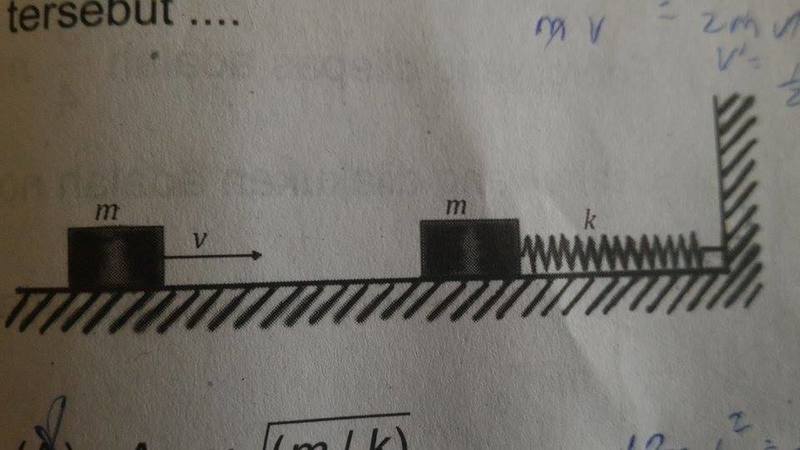

A block with mass m which is on a slippery floor is attached to a spring with spring constant k.
Another block which mass is also m approach and then hit the first block with velocity v as shown in the figure.
After the collision, both blocks stick together and together oscillates on the spring.
The amplitude of the oscillation is

Momentum and energy conservation (I think)
[/B]
Since both blocks stick together, it's inelastic collision.
m v = 2m v'
v' = (1/2)v1/2 (2m) (v')^2 = 1/2 k (Δx)^2
m (1/4) v^2 = 1/2 k (Δx)^2
Δx^2 = (1/2)v^2m/k
Δx = v √(m/2k)
So, I choose D as the answer..
