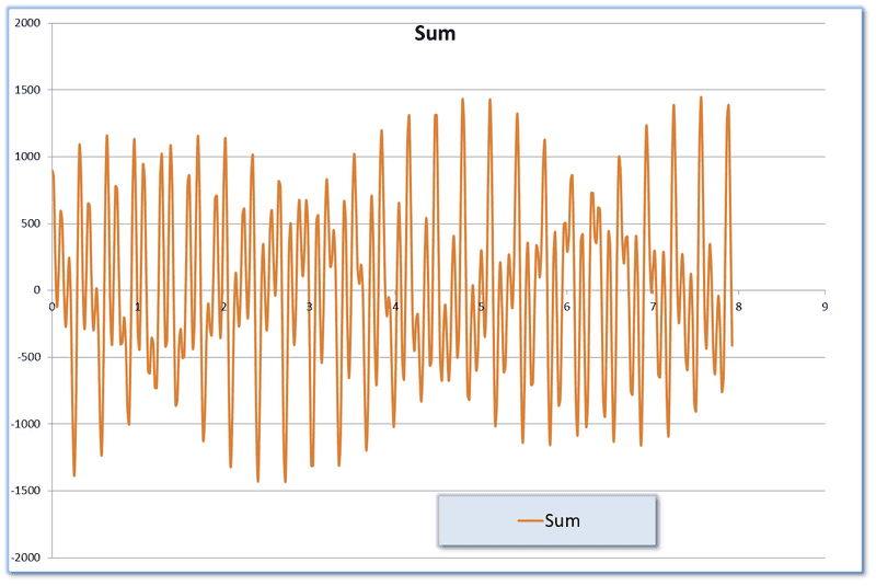

Find the amplitude of forces of superposition of 300## \cos13πt## , 500## \sin6.4 πt## + 300## \sin 13πt ## +600## \cos 18.8 πt##
Find the amplitude of forces of superposition of 300cos13πt, 500sin6.4 πt + 300sin 13πt +600cos 18.8 πt
My answer is ## \sqrt((300^2)+300^2)## = 424 after superimposing both ##cos13πt## and ##sin13πt##, After which, the overall of amplitude of superimposed of all 4 forces are ##\sqrt( (434^2)+ (500^2) + (600^2))## = 893, correct me if I am wrong
I agree with the 424, but what is your reasoning to add the others in quadrature ?

The plot in #2 shows function values of + and -1429, so you cannot be right ...

Homework Statement: Find the amplitude of forces of superposition of 300## \cos13πt## , 500## \sin6.4 πt## + 300## \sin 13πt ## +600## \cos 18.8 πt##
Presumably there is a simple typo' so that
should be
300## \cos13πt## + 500## \sin6.4 πt## + 300## \sin 13πt ## + 600## \cos 18.8 πt##
To add to what @BvU has already said, note that at t=0 the cosine terms are all 1 and the sine terms are all 0, so the total force at t=0 is
300*1 + 500*0 + 300*0 + 600*1 = 900.
This exceeds your calculated amplitude!
Your method of amplitude-addition generally only works for 2 terms with the same frequency and a phase difference of ##\frac {\pi} 2##.
It looks like the problem can only be solved numerically - if this is course-work you are probably expected to do it this way. What course are you on?

To use the ##\sqrt {A^2+B^2}## 'rule' the frequencies must be the same and also the phase difference must be an odd multiple of ##\frac {\pi} 2##. For example it works for ##3\sin(2t) + 4\cos(2t)## or for ##5\sin(11t + \frac {7\pi}2) + 2\sin(11t)##.
rc2008 said:
for superposition of sin + sin / cos+ cos / sin+cos curve with different frequqncy, i can only just simply add up to get the magnitude of superimposed curve, correct me if I am wrong. 424+500+6001524, still exceed 1424 as @BvU pointed out. :confused:
If you add up the individual amplitudes (424+500+600=1524) this gives the upper limit for the final amplitude - so you know the final amplitude cannot be greater than 1524. This could be a useful check once you have an answer but it does not help you to find the answer.
To find the amplitude you could use calculus (to find a maximum) but you will usually not end up with something that can be solved analytically. Finding the amplitude will usually require a numerical method (e.g. using MatLab). If only an approximate value is required, then it can be read-off a graph such as @BvU 's.

No. The 2 'waves' to be added must in 'quadrature'. That means there must be a quarter-cycle shift (##\frac {\pi}2## radians) between the 2 'waves' (or, more generally, a shift of an odd number of quarter cycles).
For example, ##\sin x## and ##\cos x## are in quadrature. But remember that ##\sin x = \cos(x- \frac {\pi}2)##. So ##\sin x## is not in quadrature wirh ##\cos(x- \frac {\pi}2)##.
You can use sites such as https://www.desmos.com/calculator to draw the graphs. Or use a graphing calculator or laptop+software or similar.
Sketch the graphs of ##y=5\cos(11t + \frac {7\pi}2)## and ##y=2\sin(11t)## for yourself. You will see the graphs are in phase, not in quadrature.
Generally, if the 'waves' do not have the same frequency and/or are not in quadrature, there is no shortcut formula/method I know of. Drawing the graph would be simplest/quickest method in this situation (IMO).
Edit: An advantage of drawing the graph is that you will see the local maxima (as well as the global maxima) as noted by @FactChecker. This could be very useful information, especially if some local maxima are large.

Consider two periodic continuous (not necessarily sinusoidal) real functions of time, ##y_1## and ##y_2##, with respective periods ##T_1## and ##T_2##.
The sum, ##Y = y_1 + y_2##, has a period which is the least common multiple (LCM) of ##T_1## and ##T_2##. That’s the shortest time-interval both functions will have simultaneously completed an exact integer number cycles.
So to find the amplitude of ##Y##, it is necessary to find the maximum value during a time interval equal to LCM(##T_1, T_2)##.
The argument extends to the sum of any number of periodic functions.
_________
Now consider the original problem. Note that the function ##y = sin(\omega t)##, for example, has period ##T = \frac {2\pi}{\omega}##.
In the Post #1 function, there are 3 different angular frequencies: ##\omega_1 = 13\pi, \omega_2=6.4\pi## and ##\omega_3=18.8\pi##.
The corresponding 3 periods are therefore:
##T_1= \frac {2\pi}{13\pi} = 2/13##
##T_2= \frac {2\pi}{6.4\pi} = 2/6.4 = 20/64 = 5/16##
##T_3=\frac {2\pi}{18.8\pi} =2/18.8 = 20/188 = 5/47##
LCM(##T_1, T_2, T_3##) = LCM (2/13, 5/16, 5/47) = 10, so the amplitude corresponds to the largest value within any time-interval of 10 (unknown time-units).
Carefully inspecting a graph covering t=0 to t=10, I found the maximum is 1479.173 at t=4.78611, though there are similar (slightly smaller) local maxima.
