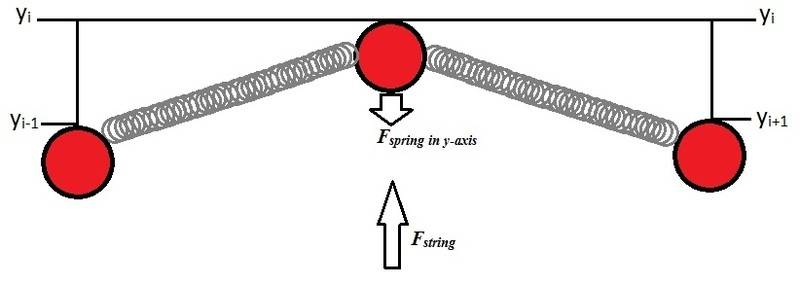

Thanks. I'm trying to visualize here what you're saying. I assume the balls are the air molecules. Because in my head, I pictured a horizontal model where the string hits an air molecule and that air molecule hitting the second, etc. like this:
And then using this model to calculate the speed of propagation of the wave copmression. Since a higher amplitude gives a larger vibration velocity, this would give a larger Fstring. However, I'd have to prove that this doesn't influence the speed of propagation, I assume using the mass of the air molecules and the spring constant and the resulting acceleration of the molecules.

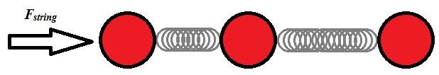

Your descricption however made me picture it like this.
Here the middle air molecule got already moved the force of the string, and I guess you're trying to calculate the deceleration caused by the increased spring tension that wants to pull the middle air molecule down, which compensates for the acceleration caused by the string force?
I started to do the longitudinal version, but it made the notation messy. For each ball I needed a displacement from initial position: delta xi and I needed the spatial dimension x for the derivative. I wanted to call them both x so it was clear they were on the same axis, but I needed to be clear the were different things. In the end I chose clarity. The math is just the same for the transverse wave and the notation is easier, so that is what I did.
Yes, I am calculating the restoring force, and it is proportional to the second derivative. Make any straight line with your three balls, and regardless of displacement the net force on the middle one is zero. His restoring force is proportional to the difference of what is happening to his left and right, and that is the second derivative in space. The second derivative in time (force, acceleration) is tied to the second derivative in space (curvature) and the speed of the wave becomes fixed regardless of amplitude or frequency.

From what you are writing, I can't be sure whether you are trying to model the oscillations of the string or the transmission of sound through the air. Sound in air is strictly a longitudinal wave (molecules can't make each other move transverse to the wave).
A string, otoh, has a transverse wave. But the fact that they are different forms of wave is not necessarily relevant.
Which are you interested in - sound or vibrating strings? Remember, a simple vibrating string doesn't deliver much energy into the air and it is necessary to couple the string to a diaphragm / soundboard , as in a banjo or guitar, to match the string to the air and to get any significant sound out of the string. Sound propagation would usually be described in terms of a vibrating 'piston' as in a loudspeaker, where the energy is supplied over a relatively large area and produces a wave front that is plane over a big area (the simplest way to look at it).

I now understand that the full transfer of the kinetic energy of the first air molecule occurs in a fixed time duration regardless of how large the compression Δx is (when it's within the proportionality limit).
This made me think about the second air molecule though. Because that second molecule doesn't necessarily have to wait that fixed time duration until the kinetic energy of the first air molecule is fully transferred to start moving as well. That second molecule could already start moving at a smaller certain compression length (< than Δx) of the spring (between the 1st and 2nd) when that spring reaches enough force to push that 2nd molecule, thus before the kinetic energy of the first molecule has been fully transferred (so before Δx has been reached). Let's call that certain length in which the 2nd air molecule starts moving towards the 3rd, length Δd (which is < Δx)
A higher kinetic energy of the first air molecule would have a larger Δx compared to the Δx of a lower kinetic energy molecule, but since both Δx's are reached at a fixed time duration, that means that a higher kinetic energy air molecule would reach that length Δd in a shorter time, thus provoking the 2nd molecule to start moving earlier towards the 3rd one. So it's more when the 2nd molecule starts to move than the time duration until the 1st molecule reaches Δx. I would therefore think that all the consecutive air molecules would start moving earlier compared to a lower kinetic energy and thus the propagation of the sound would go faster.
And yet, the propagation still happens at a fixed speed regardless of that. I might have a theory why. Because a higher kinetic energy of the 1st molecule compresses the spring more, that means that the spring has a larger restoring force, and thus pulling the 2nd molecule back stronger which compensates for its early movement.
Not sure if this is a plausible explanation though.
JohnnyGui said:
This made me think about the second air molecule though. ...
You are working towards the reason that it is the second derivative that matters. Don't think if the first molecule. Think of a molecule in the middle. He's getting pushed by the compression on one side, but he's having to push to compress the molecules on the other side. The only time he experiences any net force is when the compression on the left has a different magnitude than the compression on the right. That is the definition of the second derivative of displacement. And as you point out there is no waiting. As soon as the compression is at all unbalanced the molecule experiences a force and starts to accelerate.
Oh ok. So my described problem is already taken into consideration by the wave equation in your post #11?
Looking at your post #11, it starts to make sense now. What you've done is;
1. Calculating the deceleration by using (k / m) ⋅ Δx = a, but since a changes over Δx, you've written a down as a function of dx2 / dt2 which should be the same as k / m.
2. You then showed 2 formulae of actual wave functions that show the relationship of 1) y with the time t, and 2) y with the position x for an air molecule.
3. This means that the second derivations of those 2 wave functions, combined in a way that it is equal to
dx2 / dt2, must show the acceleration of that air molecule over time. After simplifying I got: w2/C2 = dx2 / dt2
4. Since dx2 / dt2 is the acceleration just like (k / m) is, this means that w2/C2 = k / m and thus w2 = (k/m)*C2
Is my understanding of your actions correct?
One question though regarding steps 1) and 2); what are exactly the y's in those functions? Because, I see you've given the formula Y(x,t) that shows the relationship of Y with x and t but what info does that Y give when you fill in the wave equation with known x and t values? (do you get a speed, for example?)
For clarity I've done a transverse wave. The Ys are the displacement from the equilibrium position. The math is exactly the same for the longitudinal wave. Take the yi's to mean the displacement of each molecule from its equilibrium position. It doesn't really matter whether that is longitudinal or transverse displacement. All that matters is that we be able to distinguish these displacements from the variable x which means position along the wave.
Yes, I was indeed aware that the maths are the same for transverse and longitudinal waves. That's why I used dx instead of dy in my previous post. I got confused because there's also an x variable in your formulas along with the displacement y and that made me wonder which one is actually the displacement. I thought you don't need both to know the function of acceleration. Isn't the acceleration function dx2/dt2 the same as the acceleration function dy2/dt2 since they both give how fast the air molecule is changing in space?

The subtlety comes from the two different meanings of the coordinate x. to keep from carrying around a lot of deltas you can give each and every molecule it's own coordinate system where xi = 0 for every molecule at equilibrium. However when you write the wave equation or take a derivative to see how things vary along the length you need a global x coordinate. Rather than try to explain that I called the individual displacements "y" and said it's transverse.
