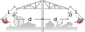

In an amusement park rocket ride, cars are suspended from L = 4.37-m cables attached to rotating arms at a distance of d = 6.09 m from the axis of rotation. The cables swing out at an angle of θ = 53.9° when the ride is operating. What is the angular speed of rotation?
(mv^2)/r = mg
wr(angular speed) = v
Okay, so first I calculated the total radius which was 6.09 m + (sin53.9)(4.37) and got a radius of 9.62 m. Then, since there is no normal force, the tension is equal to mg, thus making mv^2/r = mg. Masses cancel out and I got v^2/r = g I got a velocity of 9.7145 m/s. Using the angular speed equation : wr = v. For angular speed I got 1.01 deg / sec. Computer says this is wrong, what did I do wrong?
Errors here! You must separate the vertical forces from the horizontal ones.
The tension is partly vertical and partly horizontal, so you'll need sine and cosine.
Write two separate equations for the horizontal and vertical forces.
I expect you will have two unknowns to find with your two equations, though you are probably only interested in one of them.
I only have one try left, and I'm almost positive that I use the velocity of the x component which utilizes the equation : v^2/r = tan53.9(g)
Is that correct?
I got angular speed of 1.18 deg/s which appears to still be wrong...sigh what am I doing wrong now?
v^2/r = tan53.9(g) looks pretty good, though I have no idea how you could get it without separating the vertical and horizontal forces.
It is 1.18 radians/s for the angular velocity.
Okay, I guess I'll have to ask my teach about it because 1.18 radians/s is wrong :(
Thanks for the help though!
