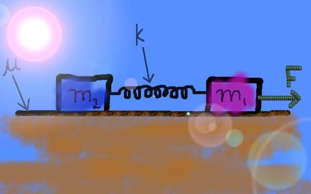

Two bodies of mass m1 and m2 are placed on a horizontal table with coefficient of friction [tex]\mu[/tex] and are joined by a spring. Initially, the spring has its natural length.
If F is the minimum force which, when applied on m1, will make the other block m2 just move, find F. (k is the spring constant)
Here is an artistic illustration of the situation.
  1. Limiting Frictional Force = [tex]\mu[/tex] x Normal/reaction offered by the surface.
  2. Force due to spring = k * Elongation of spring (from its natural length)
If m2 is to move, it needs to experience a force of [tex]\mu m_{2}g[/tex] (to oppose the friction), which can be only experienced from the spring.
This means the spring's elongation at that instant is atleast [tex]\frac{\mu m_{2}g}{k}[/tex].
An equal and opposite force acts on m1. For m1 to move, net force on it must be greater than [tex]\mu m_{1}g[/tex].
That gives [tex]F=\mu m_{1}g+\mu m_{2}g[/tex], which is incorrect.
The answer is [tex]F=\mu m_{1}g+\frac{\mu m_{2}g}{2}[/tex], which I have no idea of where it could possibly come from.

Hint: Realize that the applied force just has to be enough to get m1 moving and stretch the spring the right amount. Think in terms of energy.

Ask yourself: If you applied such a force through a distance x (the required elongation), how much energy will m1 have? If m1 has extra energy beyond that needed to stretch the spring, then you've pushed too hard. Note that the spring force is not constant.
Sorry, i meant ug(m1+m2). Does the problem ask the minimum constant force? If so, it is really
ug(m1+m2/2), and anyway, it is less than ug(m1+m2), so you are right... :blushing:
So we apply a constant force F along a path Δx, first accelerating m1, than letting it decelerate, stopping at the end. According to the Work-Energy Theorem, the work of all forces equals to the change of KE which is zero now. So
W=(F-μm1g)Δx-kΔx2/2 =0, F=μm1g+kΔx/2
