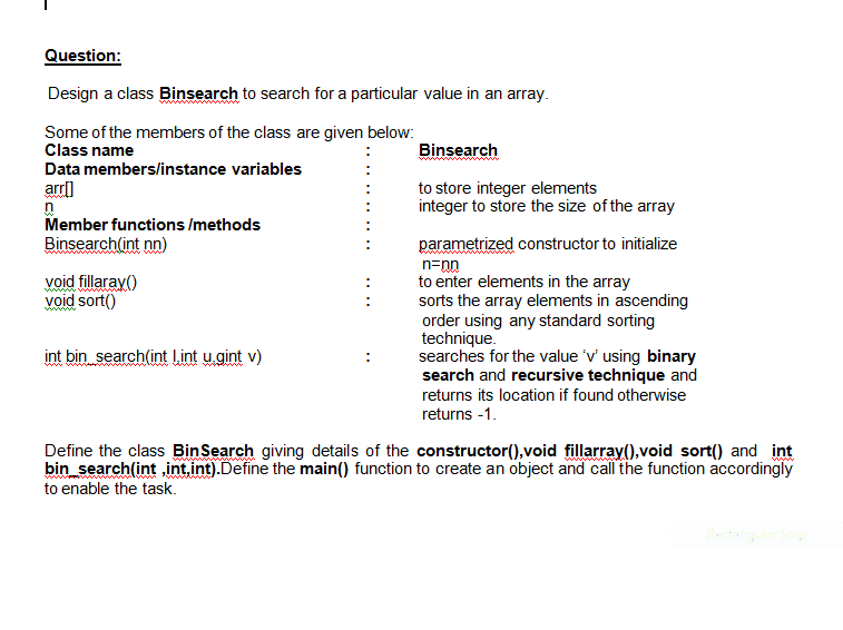

Summary:: I have to solve this problem stirctly according to the question that follows:
Mentor note: I edited the original code to add indentation and a few blank lines to make the code more readable, so line 43 is no longer the line in question.
so this is the question i tried but it gives error in line 43 of my program it is only when the element to be searched is not present int the array while it must print "ELEMENT NOT FOUND "message if the element is absent .
foollowing is my program and output.

Sorry but we can't modify the parameters given in the question.
Really? Are you saying that your instructor will mark your program down if you use parameter names that are more understandable as to what they're being used for? I find that really hard to believe. No reasonable instructor would mark down for using parameter names that make it clear what they are to be used for.
I see that you changed the name of one method to fillarray(). In the program statement, it was fillaray, in which "aray" is the misspelled version of "array".
By some pure coincidence, I had solved that exact question (which the OP has posted) back in high school. I am guessing that the OP is from the same country as me. Here, instructors are unreasonable, and they will not allow you to change the parameters that are defined in the question. If parameter names are changed, the student's marks are deducted for not following the question. Awkward, but true!
@anyonebutangel which IDE are you using for writing the programs?
That is ridiculous, pedantic, and completely unreasonable!
I wonder if the instructor will deduct points for changing the name of fillaray to the name that the OP is using, fillarray? I deduct points from students if the change the names of functions, but I don't care about the parameter names, as long as they are informative names.
True, but that's the reality unfortunately.
If this question comes in an exam, then you are supposed to follow the question word by word. That means students are supposed to use misspelled function names. If, however, the question is given as a part of a project (like it was in my case), then one can usually have a word with the teacher about this. If a change has to be made, it has to be made for the whole class.

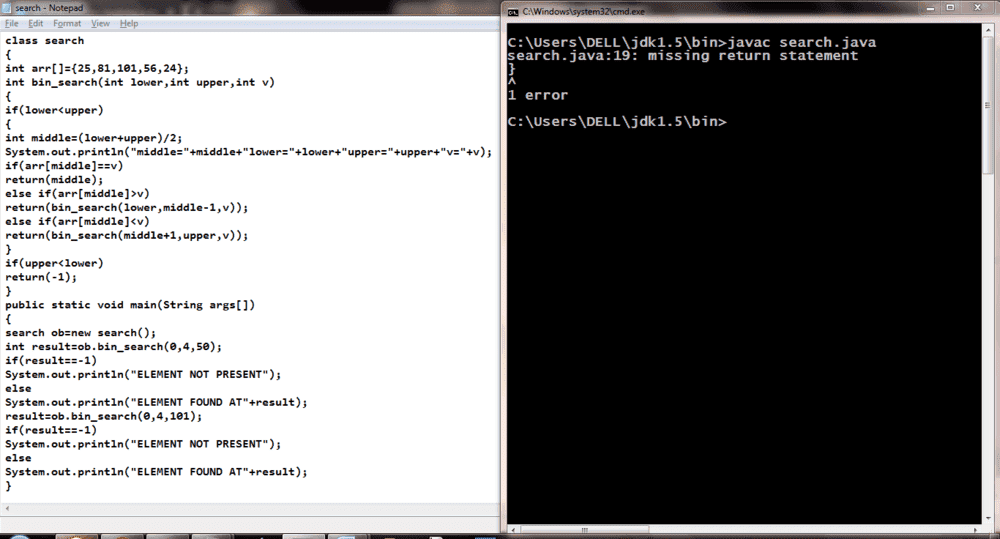

guys i designed another program with same method(int bin_search).once I get the cause for error,i'll change it in the main program.have a look.
i hope it"s easier to read.and i Still can't get it where the problem is.
Mark44 said:
Are you sure that the code you showed here is the same as the code that the compiler sees?
yes.I have only one file with that name and also for execution I'm entering the path of file for compilation .so yes i"m executing same file.

But I'm not able to figure out why is it giving "missing return statement".

yeah i get that.But I'm not able to figure out why is it giving "missing return statement".
Look at this portion of the code that you posted earlier:
Java:
int m=(l+u)/2;
System.out.println("m="+m+"l="+l+"u="+u+"v="+v);
if(arr[m]==v)
    return(m);
else if(arr[m]>v)
    return(bin_search(0,m-1,v));
else if(arr[m]<v)
    return(bin_search(m+1,u,v));
Your if-else conditions include equal to, less than and greater than v. Fine, that covers all the cases possible. But the compiler doesn't understand that. It is asking you: what if none of the above conditions are met? The compiler doesn't know that there can be no other condition. The solution is to simply change one else if to else.
Very good point, and one that I didn't consider, as I was focused on the statements in the if and else if clauses.

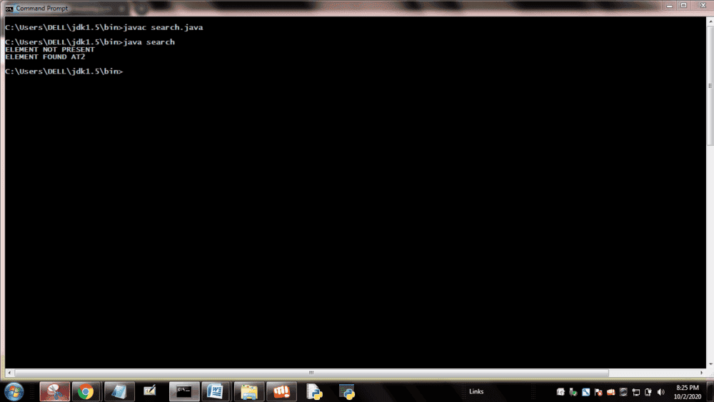

Hey guys ,Figured out.
If you want to have a look
Java:

THANK YOU
Much better! Your code is in code tags, it's indented, and you have informative variable names. All of those make it easier for people to read and understand your code, and to provide whatever help might be needed.

           search ob=new search();
           int result=ob.bin_search(0,4,50);
           if(result==-1)
                   System.out.println("ELEMENT NOT PRESENT");
           else
                 System.out.println("ELEMENT FOUND AT"+result);
                result=ob.bin_search(0,4,101);
           if(result==-1)
          else
