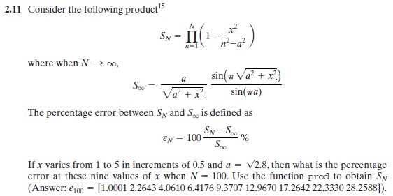

x=1:0.5:5; a=sqrt(2.8);
n=[1:1:100];
Sn=prod(1-(x.^2)./(n.^2-a^2));
S_inf=(a/sqrt(a^2+x.^2)).*sin(pi*sqrt(a^2+x.^2))/sin(pi*a);
e_n=100*(Sn-S_inf)./S_inf
I know I can't use ./ if the two matrices are different, meaning x./n.
How do I use the prod function without going through this issue?

Your best bet is to use matrices instead of a for loop.
Code:
% define input
N = 100;
x = 1:0.5:5;
a = sqrt(2.8);
% Create big matrices
X = repmat(x, [N,1]);
n = repmat( (1:N).' ,[1,length(x)]);
% Calculate Sn
SN = prod(1-X.^2./(n.^2-a^2));
% Calculate inf values
Sinf = a./sqrt(a^2+x.^2).*sin(pi()*sqrt(a^2+x.^2))/sin(pi()*a);
% Caclulate eN
eN = 100*(SN-Sinf)./Sinf

Yess! This is much nicer. I also feel that I have to apologize for my 'best bet' part.
I just thought that less computation time would be more efficient.
