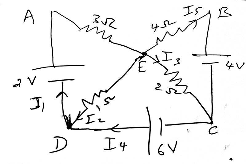

An electric circuit is as shown in diagram below. Determine the current through the 6 V battery.
Kirchhoff's Junction rule and Kirchhoff's Loop rule

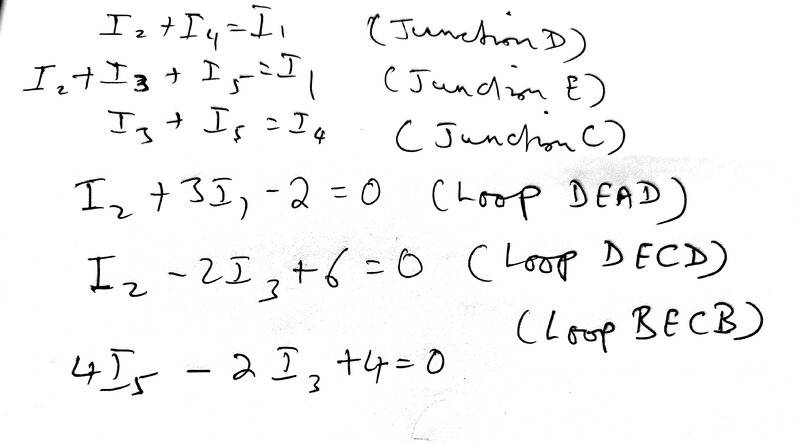

I came up with the following set of equations. I try to express all currents in terms of ##I_1## and then substitute in the first equation to get the value of ##I_1##. Since ##I_4## needs to be determined and I have already expressed it in terms of ##I_1##, so it can be calculated. The problem is that I get a value of ##I_4= \dfrac {62}{25}## A when it's given in the book as 2 A. I am not sure if my approach of expressing all currents in terms of ##I_1## and then substitute in any equation is the correct way of solving such system of linear equations in 5 variables. We're not allowed to use online equation solvers, but we need to solve them manually.
Another problem is that how can I know that all equations I get by applying Kirchhoff's laws are independent, If I look at the first 3 equations I got then I can clearly see that when second and third equations are combined they give the first equation. I used to think that each application of Kirchhoff's rules to a different loop or junction will yield an independent equation, but clearly its not the case with the above set of equations.

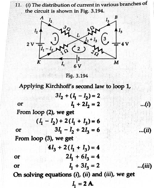

I checked the solution in the book and it seems to be wrong when applying loop rules to loop 2 and loop 3. So, the answer of ##I_4= \dfrac {62}{25}## obtained from online equations solver seems to be correct, provided my initial set of equations obtained by applying Kirchhoff's laws were correct.

If you have N junctions you only get N-1 independent equations from junction rule.
Likes vcsharp2003
Also, you have 5 unknown currents and 6 equations. One of the 6 equaitons cannot be independent.

Note, in this problem there are six possible ‘loops’ I can see. Apart from the three you have used, there are AEBCDA, AECDA, and BCDEB.
One strategy is this:
With N=3 nodes you set up N-1 = 3-1 = 2 equations using Kirchhoff's 1st law (junction rule).
Since you have U= 5 unknowns (currents) you need to setup a further U - (N-1) = 5 - 2 = 3 equations using Kirchhoff's 2nd law (loop rule). You must select (3) loops which together cover the whole circuit.
I'd guess that strategy should always work. (But if I'm wrong I am confident someone here will correct me!)
Your equations look OK to me. But when I put the equations into an online 'solver' I get ##I_4=2.48A## which disagrees with both the official answer and your answer!

I get the same answer you did.
Actually, there's a sign mistake is in the equation for loop 1 in the book's solution. Because of the direction of ##I_1-I_2## as shown, the voltage drop across the 1-ohm resistor should be ##-1~\Omega(I_1-I_2)## in the loop equation.
There's also a mistake in the circuit diagram. The current through the 2-ohm resistor should be ##I_1+I_3##, not ##I_2+I_3##. The book's solution, however, uses the correct expression for the current in the loop equations.
Thanks for recognizing the mistakes in the book's solution. I was not able to see that current in branch LM was incorrect.
By incorporating your suggestions, the same answer (as from the original approach) is obtained for current through 6 V battery as can be seen at the following link: Online equation solver.

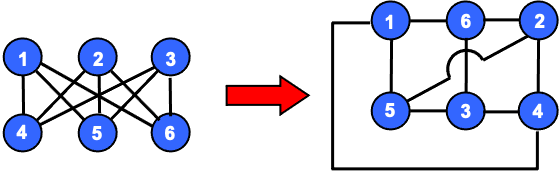

Not that impossible. First you unpack the circuit diagram by moving nodes around assuming that the blue circles represent nodes and the black lines represent circuit elements.
Then you count nodes, ##n=6## and branches ##b=9## and apply the formula found here. The number of independent loops is $$l=b-n+1=9-6+1=4.$$That makes sense just by looking at the unpacked circuit. It has 4 loops that are not sums of smaller loops therefore 4 independent loop equations.
On edit:
The figure above was carelessly drawn. See post #21 for the corrected version.

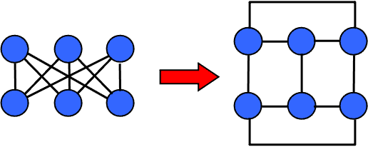

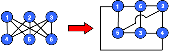

I believe that the unpacking was done carelessly in post #17. If the nodes are labeled so that the branches can be correctly identified in the unpacked circuit, the figure below is what one would get. This correction does not change the number of independent loops which is still ##4## because the number of nodes and the number of branches are the same.
vcsharp2003 said:
So, the key is to apply Kirchhoff's Loop rule to loops such that no considered loop is fully contained in another considered loop, in order to get independent equations.
I am not sure what you mean by fully contained. Look at the circuit above right. You have 5 clockwise loops
16251
52435
15341
16351
62436
They have 4 nodes each and you need to pick 4 out of these 5 loops. Which one is "fully contained" and must, therefore, be thrown out?
